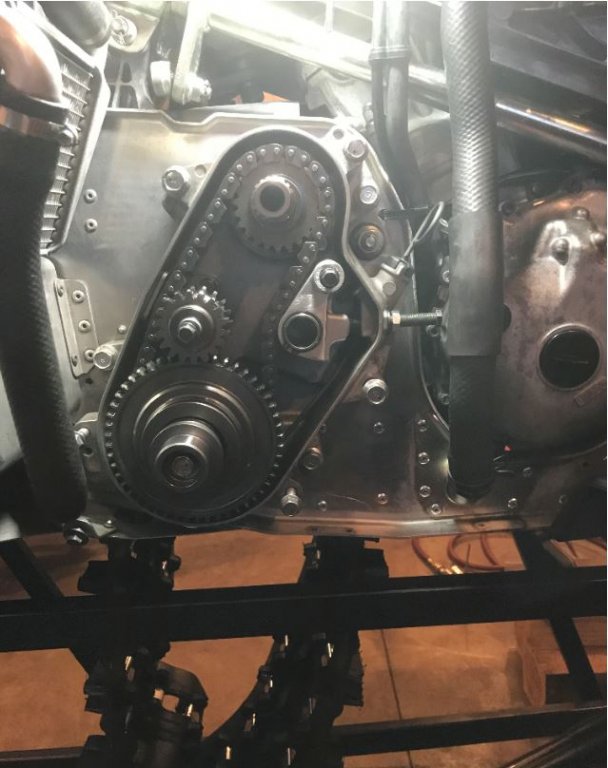

The reverse linkage needs adjustment. Too much freeplay.

A video that gives the basics. Don't worry so much about the 27mm, just keep adjusting until the there is only a very small amount of freeplay in the lever

Shouldn't do it in forward. Maybe something else wrong inside chaincase.sometimes it does it even in forward gear .. is it the same problem?

74Nitro is correct in that it shouldn't do it in forward but I also believe he's correct in that it sure sounds like it's the reverse linkage needing adjustment. It's possible that the times it does in forward is due to the improperly adjusted reverse linkage still engaging the reverse gear. There were times when my adjustment was off and it would not come out of reverse gear; it needed a little throttle to slightly inch it forward for the reverse gear to disengage.
Here's a pic of the Apex chain case to give you an idea as to what happens when you engage reverse. When you pull the lever to engage reverse, the reverse linkage 74Nitro mentioned will pull the outer bottom gear out so that it in engages with the smaller middle gear. If the reverse linkage is off, it's possible for that lower bottom gear to still be engaged with the middle gear and hence why you hear the grinding while in forward.

Now it is working ! Thank you very muchA video that gives the basics. Don't worry so much about the 27mm, just keep adjusting until the there is only a very small amount of freeplay in the lever
