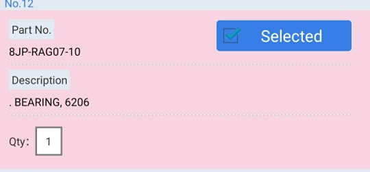

This is the jackshaft bearing on the chaincase side if you wanted oem
