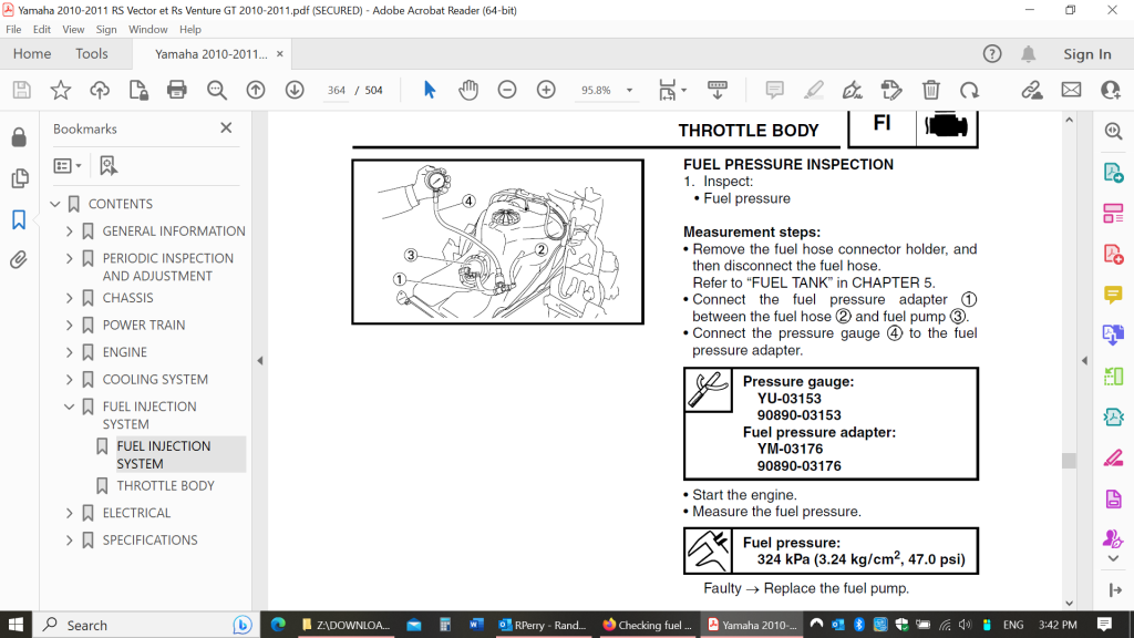

No because at WOT it's in flood clearing mode and would not spray fuel. Check on Amazon for a tester kit that has a lot of different adapters and fittings. It should have one in there that would work, like this one, which specifies also for ATVs.
And here's the procedure from the manual. It's done at the pump.
This guy found a way to do it with some ordinary fuel line and a T on a Yamaha R1 motorcycle.

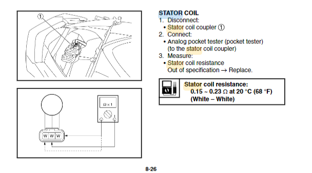

I'd like to test the Stator, is this test procedure for the grizzly applicable to our Venture EFI? https://www.partzilla.com/blog/yamaha-grizzly-yfm700-stator-testing-replacement
Cant find a full test in the service manual other than test the coil resistance wich tested ok (when cold anyway)
