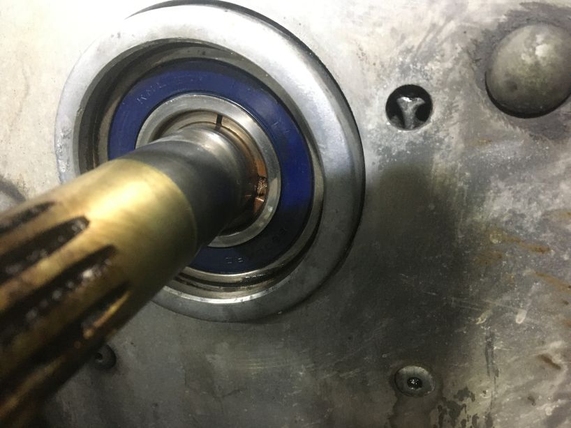

Here are a couple pictures from the other side. The split collar is pulled back in the inner race about 1/8". I have had this sled for 10 years and never touched this aside from tr-packingthe bearing grease. Should I try to loosen the nut and reset the split collar then tighten or leave it? The amount of threads showing on the other side is 3 times the 1/8" amount that this is.

Looks to me like someone has put one of those “All Balls” jackshaft bearing service kits in your sled and didn’t set that bearing lock set up properly. They use KML bearings like what’s in your pic.

“All Balls” don’t make bearings, they just package a bunch of parts together as a kit to do the job. KML happens to be their bearing manufacturer of choice.
If it was me? I’d pull that cheap cheesy bearing out of there and replace it with an OE bearing from Yamaha. You need to split the chain case and remove the jackshaft to replace that bearing. If you’re going to that trouble you may as well use the best bearing you can get……just my opinion.

Does that bearing have a taper inside.
The 14 and 15 Vipers have a taper bearing also and Yamaha is the only one that offers the bearing.

That bearing appears to be incorrect, or needs to be flipped over.

They’re definitely tapered inside the inner race. It’s either oriented the wrong way or a slightly different taper spec than the OE equivalent.
