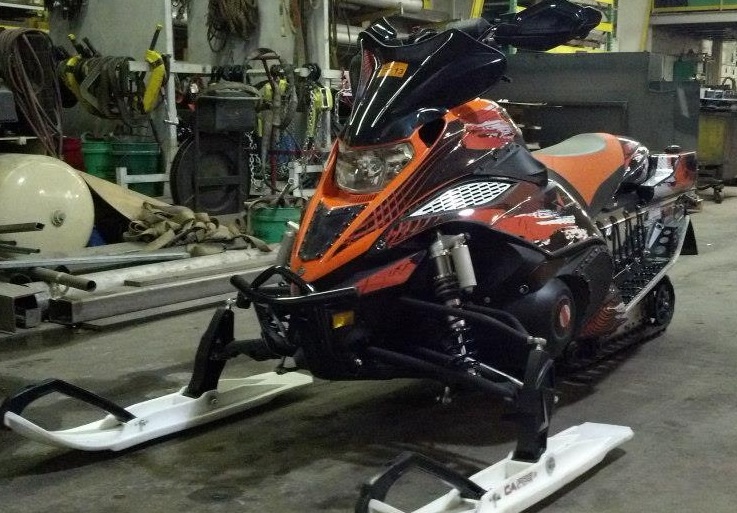

I just put the JRE kit on my my nytro xtx. Heres a pic. Ride height seems good. Lower cog than before which seems to be what everybody tells you to do with your ride height. The skinz kit seemed great but other than price i wasn't sure about changing all those parts for durability reasons. The JRE kit keeps almost everything stock.
Time will tell on the kit. But so far very pleased.

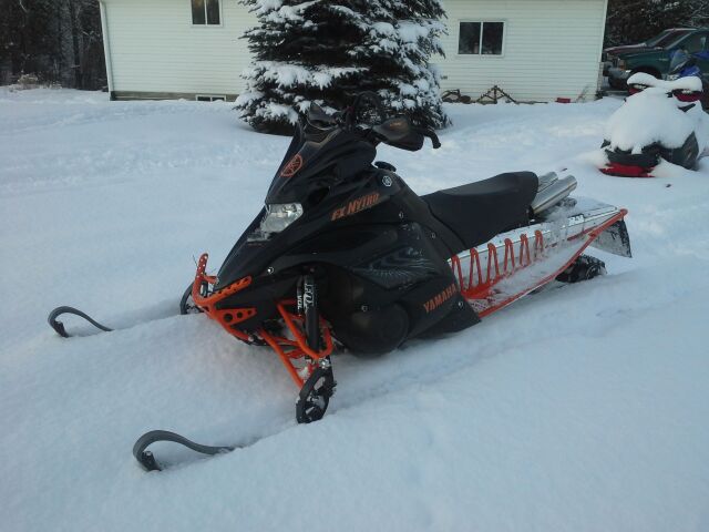

I have the ZBros 43"+1" setup, and it perfect. Flatter stance, beefy construction, almost no ski lift in the corners. Great product
Love the look of mine also now. Just looks tough.. Also no modifications to shocks needed. Comes with new spindles, and you can get beefier him joints from them also cheap.
