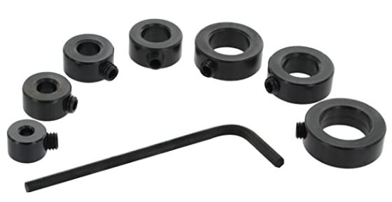

When replacing the front heat exchanger, I too was worried about drilling out the rivets so I ended getting/using these drill bit stops.

Also, black tape wrapped around the drill bit works in a pinchWhen replacing the front heat exchanger, I too was worried about drilling out the rivets so I ended getting/using these drill bit stops.

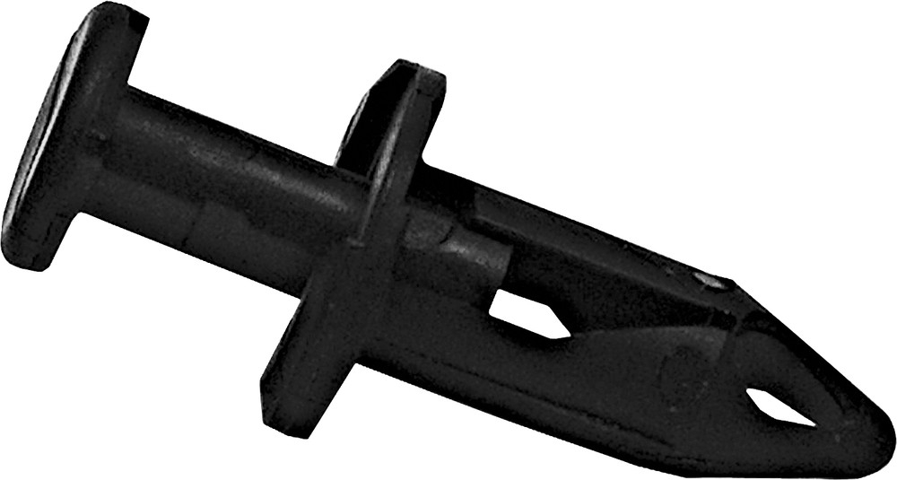

Barn of parts sells pop pins that I am going to try on my new sidewinder. Ive done the rivnuts on 3 sleds now, they are alright, but I think i might be happier with the pop pins, and they are cheap enough to carry spares.

these?? maybe......

I would not use those on the belly pans.these?? maybe......
