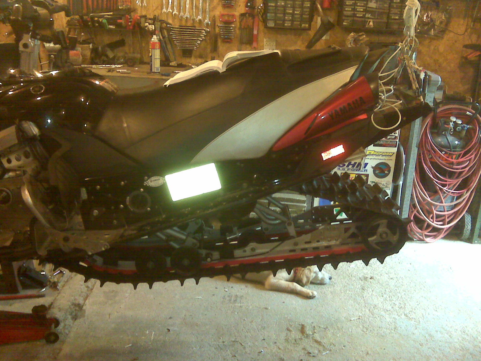

I have the muffin works tunnel and rail extension...I went from a 121-136 on my '06 Apex...I put 50 kms on it the other day and it feels great...I also went with a 1.5" lug track...it clears...
