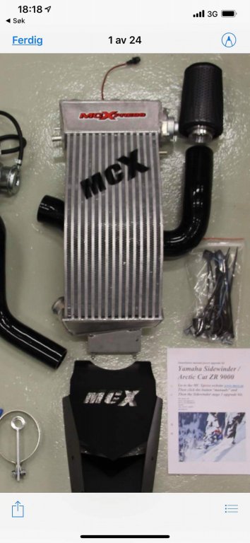

Got a problem the other day.
I drive at sea level and have a 270 tune. Put in a bigger fuel pump and everything was working 100%.
Was seeing 17 psi of boost and pulling around 9300rpm.
But got a problem with high intake temp some times so i got a stage 3 intercooler from mcxpress.
Now i got Nice and steady intake temps but i only got 14 pounds of boost and 8200-8600 rpm.
I have also drilled up the red fuel return elbow.
Air/fuel ratio is good at around 11.8 at WOT.
Anybody have any tips?
I have also pressure testes the cooler and lines to 20 psi with no leaks.

Pictures of flanges ?
Zr900turbo
- Jan 22, 2019
- 13
- 93
- Norway
- Norway
- King cat
NYTurbo
- Sep 26, 2017
- 1,601
- 1,395
- 1,038
- Ottawa
- Sidewinder
Your probably ok
