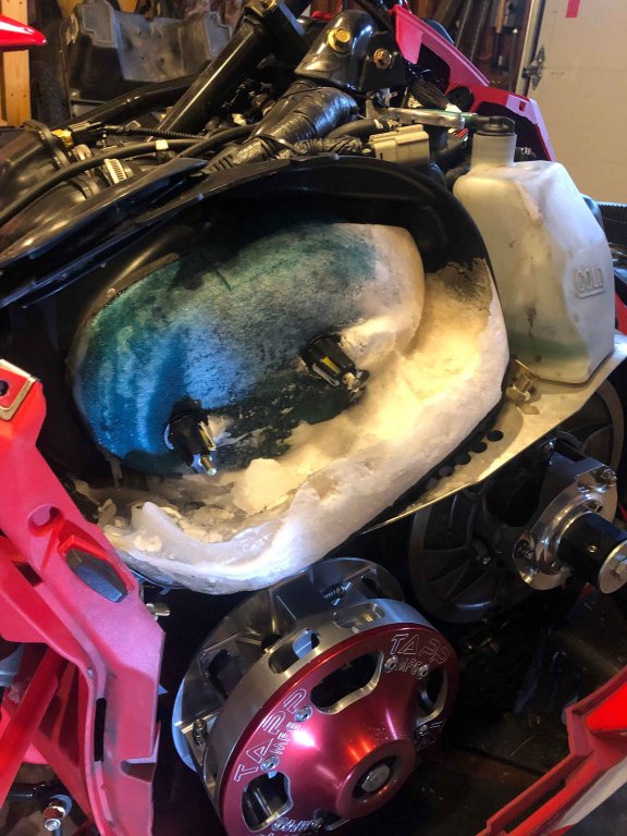

I forgot to mention I also use the GAP Ram Air intake. I was planning on taking it off before our trip last weekend knowing how cold it was going to be and the snow dust. Well, after looking briefly as to why my boost was so low yesterday, I decided to open up my airbox. Look at what I found!!!!
There must be some hose/line froze after seeing this! I put the stock airbox back on until weather warms up. Still same amount of boost at 10 lbs, so definitely something is froze besides my airbox!
Thank guys for all your help. Love this site!

Holy smokes that probably has something to with it.

Ha! My words were very similar to that when I saw that. Still only producing 10 lbs after I put the stock back on, so some lines must be frozen solid. I'll be checking later today.

Wow. I would say that ram snow system works great! I think you found your problem.

Now thats a lot of snow dust injested!!!

I did have the screen in place in the front vent of the GAP Ram Air Intake. I'm sure snow dust got in from both GAP Ram Air and also the hole in the top of the airbox. We rode for 600 miles that weekend and had just a ton of snow dust with as cold as it was and no humidity in the air. I had snow build up in a lot of places!
