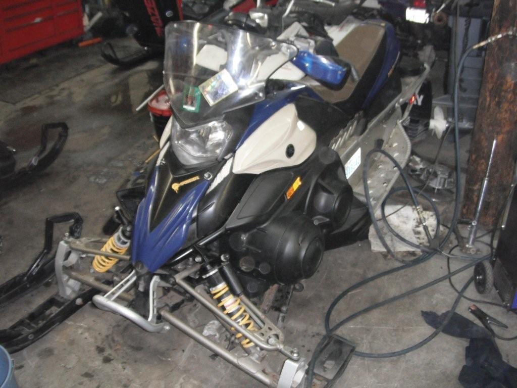

I just bought a 2007 Phazer GT with 8500Km for a pretty good price but it has a problem. It was brought in to the dealer with low compression in a cylinder after an overheat (circumstances unknown). He brought a replacement head and had it done by them saying that was the problem. So the dealer swaps the head, same problem. Customer refuses to pay for the work so he gives the sled to the dealer (with papers ). So he's selling it just to recoup his labour.
Here are my thoughts on what could be causing the low compression in the one cylinder:
- warped block deck
- replacement head also warped
- dealer botched the job (doubt it)
- damaged cylinder or block
So this will be a summer project sled for my youngest son so no rush. It also has really bad slop in the steering, it moves 5-6 inches (already know how to fix that). I just wanted to get some ideas as to what could be causing this low compression. We are picking it up this weekend and may do a quick look see if sledding conditions don't improve and have nothing better to do.
Oh, it's also ugly as sin... dark blue and off-white plastics, a brown seat, yellow springs, bronze a-arms and ugly aftermarket add-on mirrors.
- warped block deck

Me thinks that is a FX and it's purdy...

Looks like a monkeys lunch!!

gordo said:Me thinks that is a FX and it's purdy...![]()
Yup, the Phazer FX in '07 was available in Blue and Khaki. They even had matching "urban camo" jackets and pants to match the Khaki pattern that year. It will grow on you, but I ordered the blue for a reason!
Good luck, what a great project!

Mooseman said:I just bought a 2007 Phazer GT with 8500Km for a pretty good price but it has a problem. It was brought in to the dealer with low compression in a cylinder after an overheat (circumstances unknown). He brought a replacement head and had it done by them saying that was the problem. So the dealer swaps the head, same problem. Customer refuses to pay for the work so he gives the sled to the dealer (with papers ). So he's selling it just to recoup his labour.
- warped block deck
Thats the color mine was when i got it, i only have the copper a arms left to get changed to my liking..
