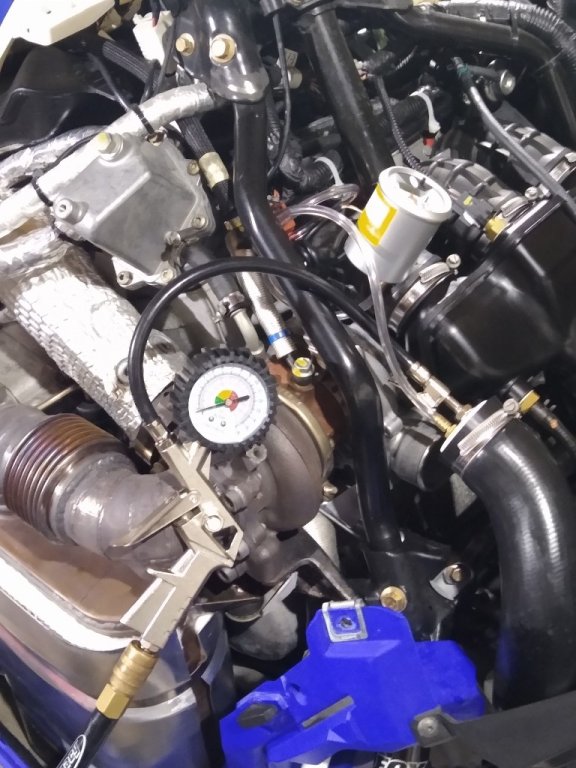

I think I'm very close to things. If I am correct I am leaking 1.5 lb of boost somewhere. I'll get itThis is why I like to have my sleds dynoed to make sure sled is making power the tuners claim. When motor is right, then you know it’s all about your clutching and gearing!!!! My $.02……

I boost up to 18.2 lb for about a second and the rest of the run it drops down in the 16s.
I'm sure that's got to be causing my RPMs and weight to go from one thing to another.

sooo between you and i for the cost.... order the front and rear boots for throttle body and the 9 clamps, grind the six clamp spacers dwn .100 shorter and then smear very lightly the boots with a really good urethane and put on lightly clamped... then tighten after 2-3hrs, this allows urethane to cure a bit. also the clamps on your charge tube.... the vibrant ones are junk... i have the ones that iuse a bolt and tighten better. once you do this you will have no leaks whatso ever.. the reason for new clamps and boots is they distort over time and they are hard to seal after theve been distorted.

I understand....all my clamps were loose. Once I cranked the plenum clamps up, I was able to hold more better pressure. Using boost tester. You can see where the gauge would rapidly come down to 16.5psi from 20psi. Then really start to slow down. Now it's holding 18.5psi fairly well.sooo between you and i for the cost.... order the front and rear boots for throttle body and the 9 clamps, grind the six clamp spacers dwn .100 shorter and then smear very lightly the boots with a really good urethane and put on lightly clamped... then tighten after 2-3hrs, this allows urethane to cure a bit. also the clamps on your charge tube.... the vibrant ones are junk... i have the ones that iuse a bolt and tighten better. once you do this you will have no leaks whatso ever.. the reason for new clamps and boots is they distort over time and they are hard to seal after theve been distorted.
So, I'm digging deeper. Clamps at throttle bodies to elbows were loose.
I've already ground down spacers. But understand the need to seal things up.
Do you have a source for those clamps. Just so I get the right ones.

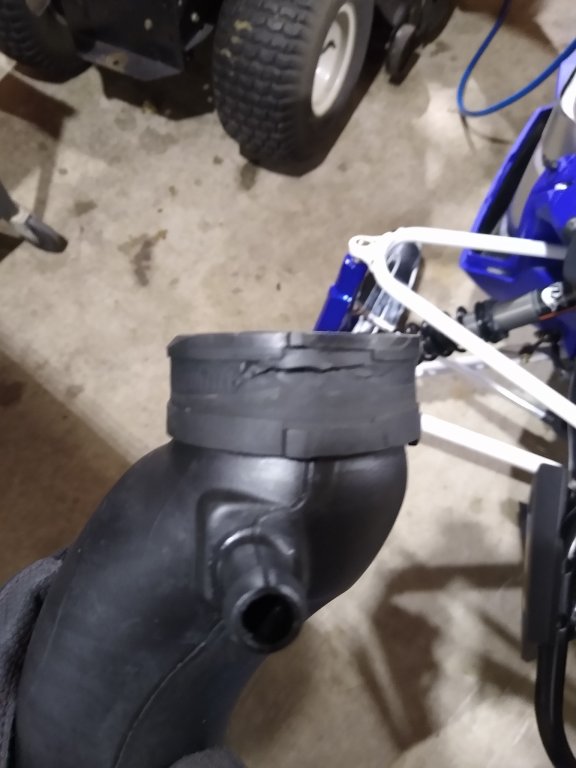

Also found this. Not sure if it would cause any other boost leak issues?????

So initially I rigged up my Boost tester and cranked it up to 20 psi. boost would slide right past to 16.5 and and speed at which the boost gauge was dropping would start to slow down.
Then after tightening the three plenum clamps boost started to hold at 18.5 PSI, better than before.

No this is a feed to turbo, draw side.Also found this. Not sure if it would cause any other boost leak issues?????

this doesn effect boost except for recycled boost from turbo smart valve... might have a biyt of lag thats all. but youl fins that the boots get deformed and it hard to redo clams as they tend to slid back int orig position. cheaper and beter to get new ones, you should be able to go up to 25lbs no leaksAlso found this. Not sure if it would cause any other boost leak issues?????

I called dealer today they said it was a month out. So I hit it with some flex tape. Sorry bud lolNo this is a feed to turbo, draw side.
I'll make sure to include pics. To be honest, Sumpbuster....it's hard to feel good about yourself when bringing the lambs to slaughter.Keep at it, jt. Blow every sled away, with no mercy. Im "riding" vicariously through you!
I'm going to do this right, as you say. One & done. Thank you for your advice.i got mine off amazon,304 stainless T bolt clamps.... but get the ones that have 2 drums and a bolt 60-63mm i think
