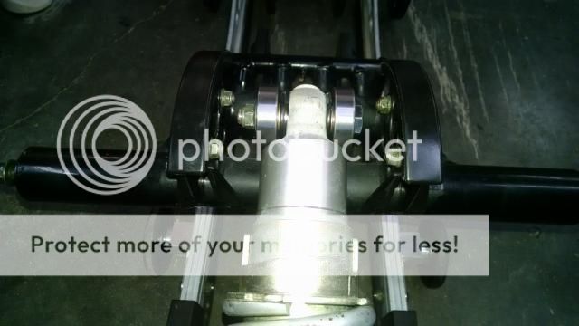

Not sure what other options are out there? Maybe fabbing up something that uses some old sliders or similar material might do the trick? I personally chose the anti rub bearings to solve mine and it works pretty slick. ;)!

Hygear suggested I turn the eye of the shock piece thats rubbing to evenly wear it down although I had no track damage it was where there studs were installed. I purchased and installed Ulmers kit. 25$ can't go wrong.

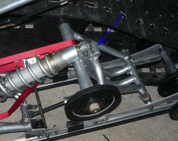

Just welded a 1" tube next to the shock end- can post a pic later if you need it.
I just ordered the anti rub kit from ulmers today, but send the pic if you can. Would like to see it. THANKS!
I bought the track rub eliminator kit from Pioneer.

I installed Ulmers anti rub kit which looks just like the Pioneer kit picture that James posted above. $25 and easy to install. Problem solved.
