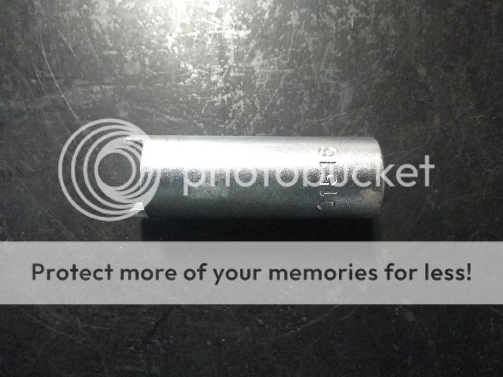

I ordered the spacer tool, being a tech like have the tools to do the job.
Tonite I got the motor back into the chassis. Followed info from service manual. Put Ulmer's tool from the crankshaft to the jackshaft, everything line up like its suppose to. This is my 162" turbo sled. After is done, will have to look at my short track nytro c to c as its out.
