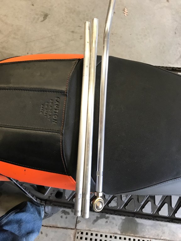

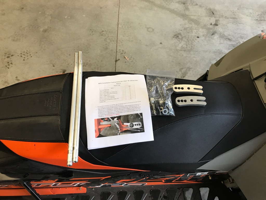

So today I installed the MPS.
Found the installation instructions here http://www.barnofparts.com/MPS installation instructions R1.pdf
Fairly easy install took maybe 40 minutes in the garage. Most of the time is spent adjusting the skis, I went with 3/16" toe out.
I took it out for a little grass drag and there is definitely an improvement.
I also polished the aluminum rods before the install

I have my sled in my shop adding a few goodies to it and am now preparing to install the MPS. I'm curious as to why we were given new outer tie rod ends? It seems the OE ends thread right in to the provided rods... Why not use the OE?

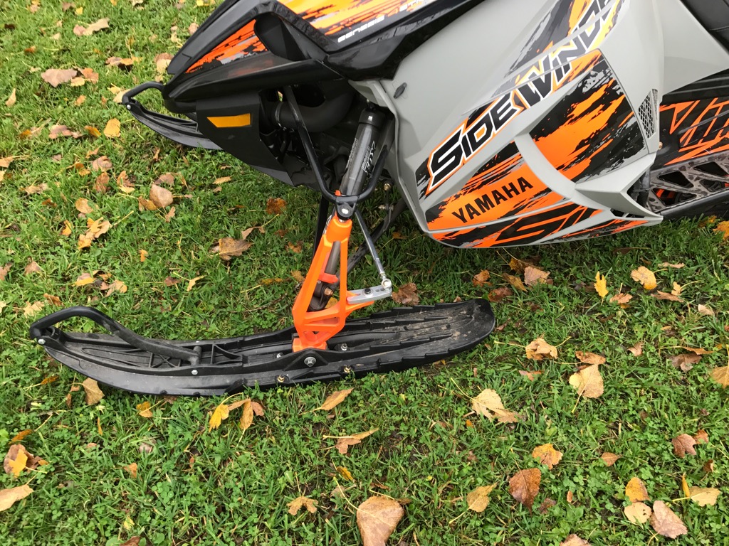

Finished up my install yesterday.
Set the toe to ZERO as I will be installing Pilot 6.9 & Trackers.

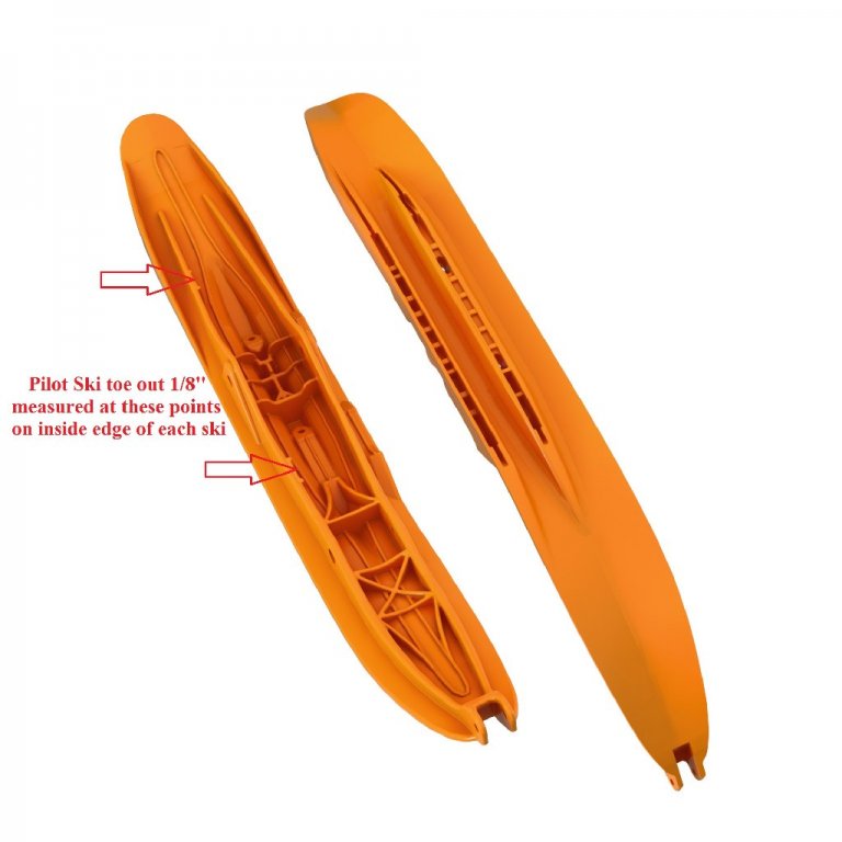

Trackers are the only setup that you want NO TOE.(Parallel) Due to their design.What should the starting point be? Even, toe in, toe out, how does this affect handling?
Most typical carbides you would prefer 1/8" to 1/4" toe, however that matters where you measure from. On Pilots there are two spots where you place your tape measure(between the little nubs) and at thost points I prefer 1/8 toe as you are not at the extreme front/rear of skis.

I primed and spray painted them. Rustoleum sunrise red. Red is a little off but I think it looks more like the blocks "belong" on the sled.

you NEVER want toe "IN". That is a no no as they now fight against eachother and cause handling issues. You can instantly tell if a sled is TOE IN, as it will be near impossible to go straight. Toe Out is used to fight darting mostly, as toe out is not common in other wheeled vehicles and would show up quickly in your tire wear.Thanks Dan. I would think toe in would provide a bit more stability while a toe out would dart more but also cut in harder during the initial turn in.
Dan
