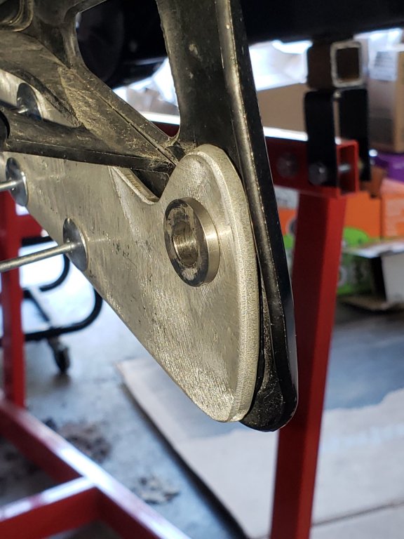

Just need to plug weld the worn hole and redrill then powder coat the brackets black.
I made the inserts out of 316 stainless steel and over sized them .001" so they are a nice tight fit.
Bracket will be fastened with 4 structural rivets

Finally had a bit of time to get some inserts machined!!
Nice Neat Work!! .....That should never egg out again

Thanks!! Skid and chaincase going back together today then I'll be installing your bushing kitNice Neat Work!! .....That should never egg out again
I am very impressed with the quality of workmanship you put into each one of the bushings machined!!! It really shows off your skills!!

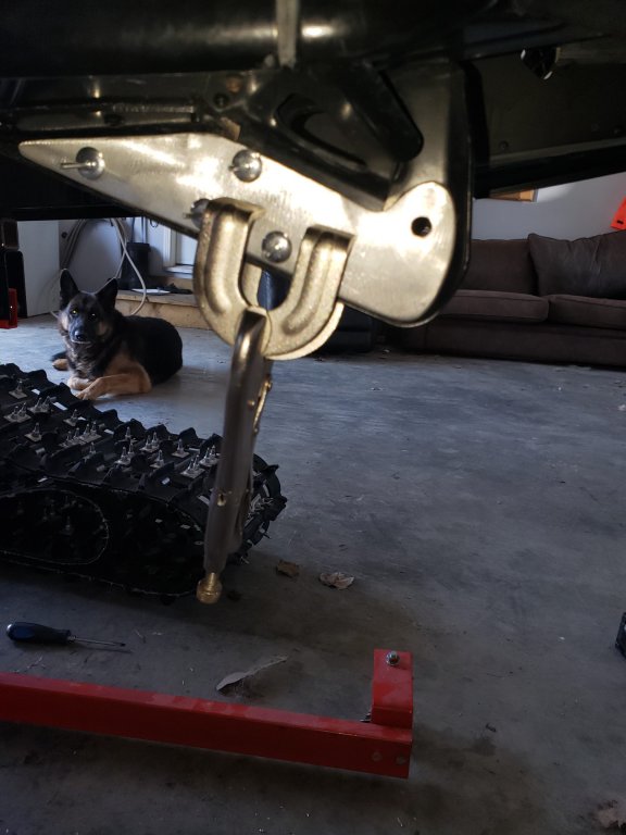

I just noticed I have the same egged out hole on one side only .This is NOT a known issue but it happened to my 2019!
Last season I pulled my skid to do a full inspection . I did torque to spec and use blue loctite when I reinstalled but over the course of the season (specifically on our 3 day 1500+km trip ) my chaincase side rear skid mount bolt loosened up and "egged"the hole.
Here is what I decided to do to repair my worn hole on my rear skid mount!!!
I decided to fabricate some 1/4" aluminum reinforcements.
As I was fabricating and trying to figure out the best repair I was talking to my buddy Hellflyer(ty member)! He offered to send me some aluminum brazing rods to fill the hole and redrill!
Once they arrive I will attempt to plug weld the hole and redrill and mount my brackets for reinforcement!!
I am just fitting the bracket once it's 100% I will have them powdercoated black and ready for a permanent install with 3/16 structural rivets
View attachment 155178 View attachment 155179

mines are shot again,,,, I plan on doing your fix...
Does the stainless sleeve go thru the Oem bracket and sit against the threaded slug?
Pics from inside the tunnel?
Thanks
yamamarc
- Sep 29, 2013
- 3,051
- Massey Ontario
- 2019 zr9000 Ltd
That’s a really nice fix
Yes it goes through the oem and is flush on the backside... so far so good no issues
I got the inserts made out of stainless and oversized them to make a nice press fit when inserting it through my bracket and the oem. If the bolt happens to loosen up again it shouldn't egg out the hole anymore
