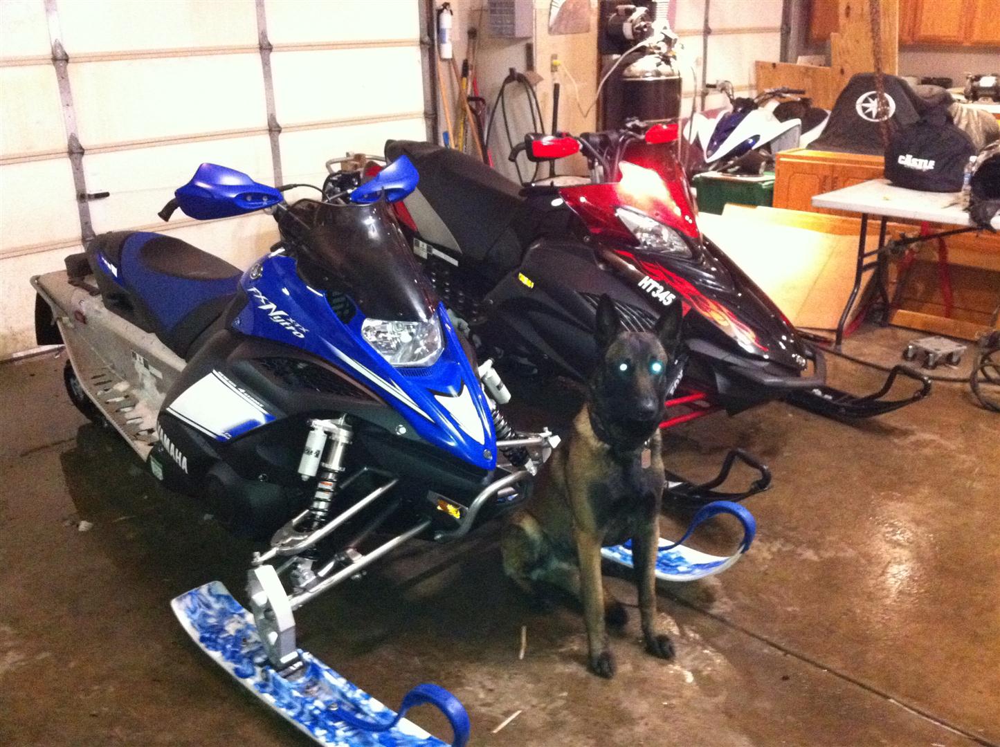

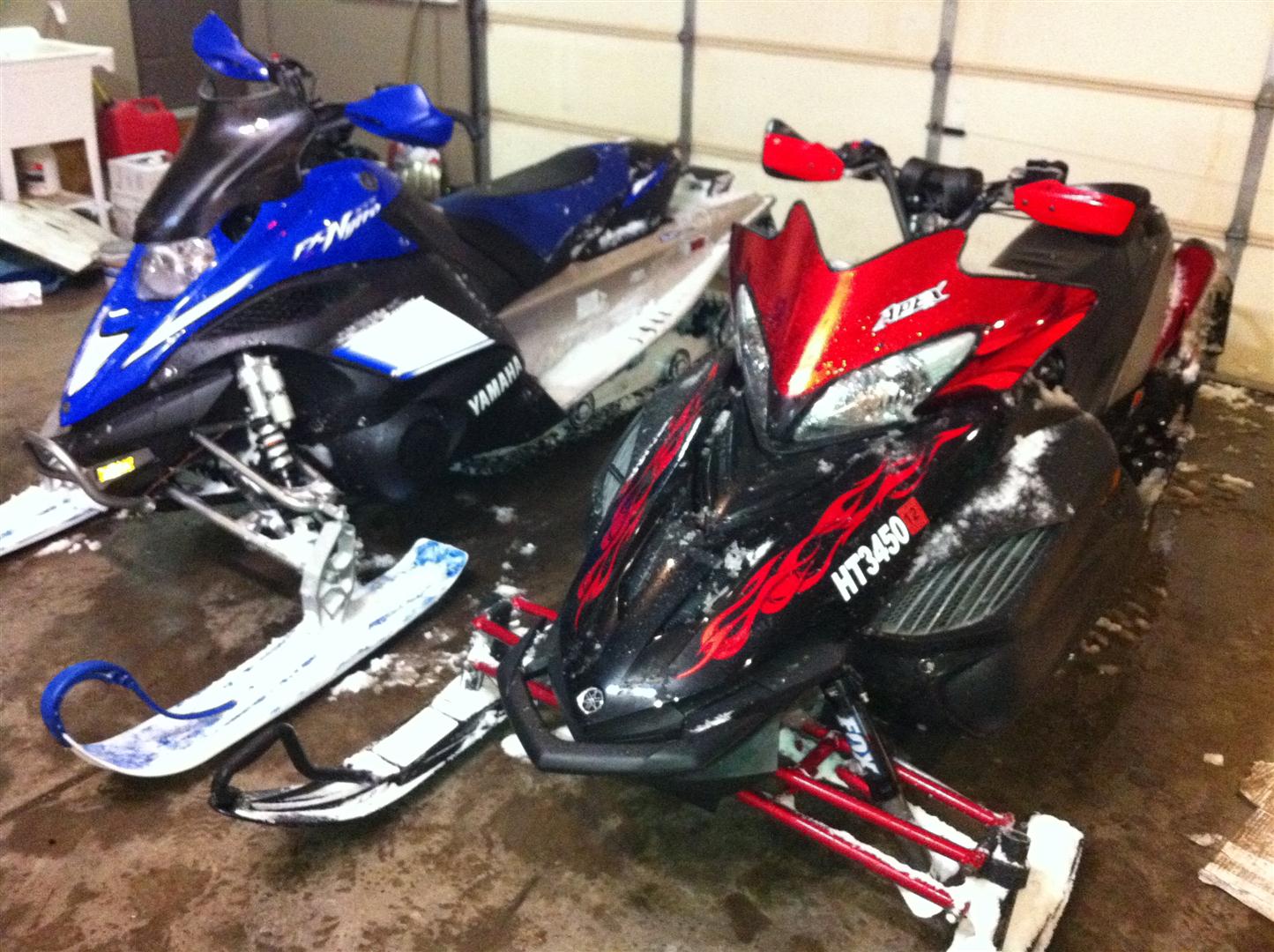

granto211 said:
well here is my projects for the next few weeks.
yamaheater= done
rox 2.5 bar risers=done
dounuts
gut stock exhaust
muffinworks 144" tip up extension
muffinworks tunnel extension
ulmers 23t gear
ulmers stage 2 clutch
new cobra 144" track
new rear idlers
here is sum pics and i will update as i go
feel free to give any input or ideas....
:rocks: :4STroke:

i love the cobra and the apex, my buddy got a new nytro xtx last night and fortunatly he has to keep it here so i get to drive it. i took it out this morn for about 20 miles. in regards to the track the nytro has stock ripsaw with studs up the middle. the cobra on my apex way out performed the ripsaw at least in the fresh powder in the ditches. hands down cobra rocks.
now about the comparison between apex and nytro?? im very happy i got a apex instead, dont get me wrong the nytro is beautiful but its not as smooth and i dont mean bumps smooth i mean power smooth and feel. nytro is great for standing but the second you sit down for a min it kills your knees and dosent want to turn. (could be suspension set up, nytro has aftermarket skies) nytro is very fun sled to just jump on and bang around for a bit but hands down the apex is much better all around sled. just my opinion. i feel if u really wanted total package a guy should have both in his arsenal or maybe apex/ phazer.
we plan to do some trail riding in a little bit and i look forward to taking the new 144" apex through the trees, so far i really havnt felt like there was 12 more inches back there as far as turning and such. i do notice it like if i burp it over a sno bank cause the track seems to ride the top of it longer so a little more gas is required so it dont nose dive .
