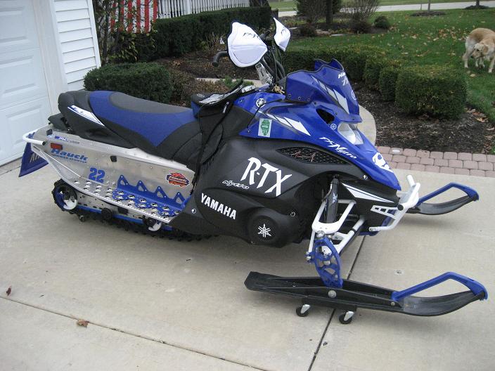

Did you change the bars? I am new to snowmobiling as I have been quading all my life. I find the bars on the nytro to be very cramped. I have protapers on my CC Grizzly and I really like them. What are you thoughts.
Your Nytro looks good. I can see this is going to be a very expensive sport for me down the road. I have a grizzly worth over 15g. I know sleds can get well over that.

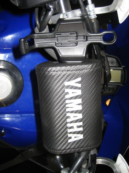

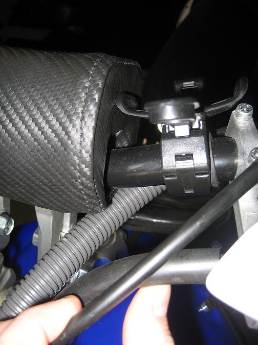

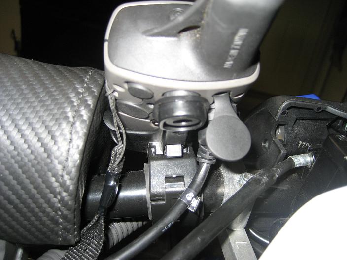

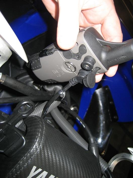

No I didn't change them. It was a challenge to find a GPS moun to fit, but I found this one on ebay pretty cheap. I have the ram but it seems a little bulky for me, and the look of the sled. If it doesn't work I will have to switch. Everything JUST fit. If I had to add a mountain strap I would need KY

Can you post some more pics of the GPS mount?

Here you go
Here is what I have. You have to run the upper knob through the hole then lock it in the bottom clip. Between that and the pad it hold it real tight. We will see what happens

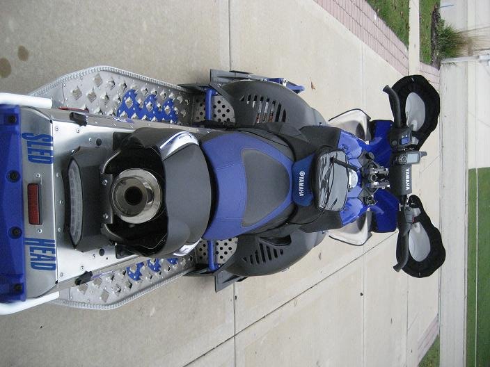

Nice job that looks very clean

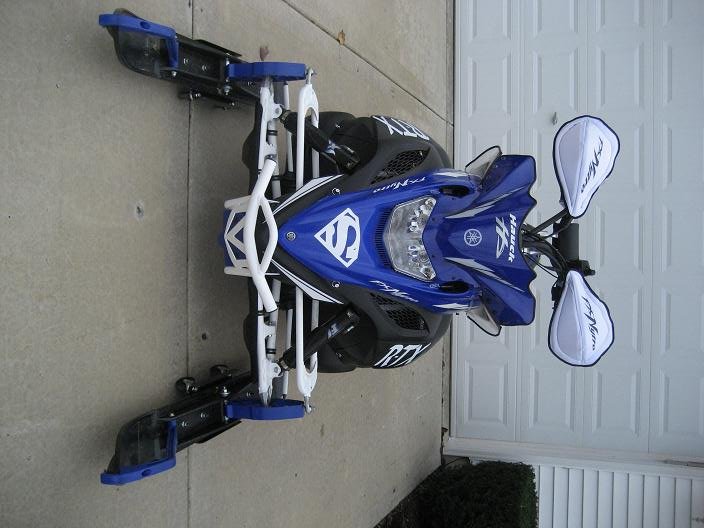

That's a good lookin' hot rod!!!
NyTrOMaNIaC
Looks good man ! Now you're giving me some ideas....
btw, how many freakin hand guards do you have anyway ??? I see at least 3 different color combos in those pics...

NyTrOMaNIaC said:Looks good man ! Now you're giving me some ideas....btw, how many freakin hand guards do you have anyway ??? I see at least 3 different color combos in those pics...
The white ones came in right before the last set of pics. I have blue and white plastic, and white oversized canvas. Don't know how long they are going to last with this new SkinZ full cover I have. That thing is tighter then a condom, and bends the snot out of my handguards. Don't know if they will want to come back when its cold out. Tried the Yamaha one, and with the sport grab bar, and riser it was difficult when it was hot out. No way it would work in the cold.

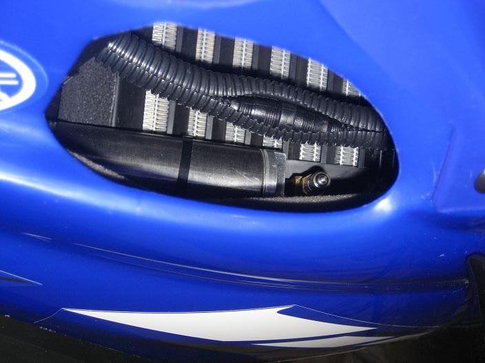

sheetwright- how did you run your wiring from your led pod above your a-arms? drill a hole or run it between the panels?
start working on mine this weekend need to get my butt going before it snows. I bought some rubber grommets to run the wiring through if I drill holes. not sure if I should put 1or 2 pods in the shock area, what do think?
oh yea..sweeet sled

lights
I drilled a hole and used a two sided rubber grommet. The lights I bought where from Street FX from Rich's Yamaha. Each of the small banks in the exhaust tunnel, and a-arm areas had 6 LED's per assembley. Which worked great. I tried to run single and hide them, but it wasn't bright enough, and it was a pain in the A$%. These light strips come with nice connectors, fuses, and holes for mounting. I used outdoor industrial black velcro, and stainless hardware throught the holes. Nylock nuts of course. All wiring went directly to the battery. I put a black toggle switch under the windshield area. If you need any more pic's just ask. I need to post K&N, and resevoir shock pic's for a couple of guys. Thanks for the interest
