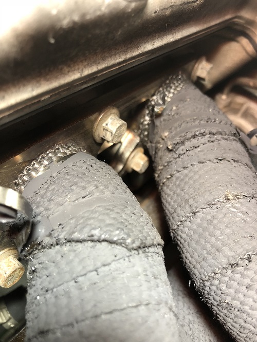

I figured if I could get my 90 degree wrench on the head of the bolt, there might be just enough room between the two pipes for me to tighten up the bolt. But even when I got it on the head, it would slip over it because the pipe was too closed to the head. I had to grind the wrench thinner to make it fit:

It took me several times grinding and fitting it but I was finally able to slip it over the head and start tightening the bolt:

all snugged up

Omg it’s amazing the sled even ran with the header like that.
