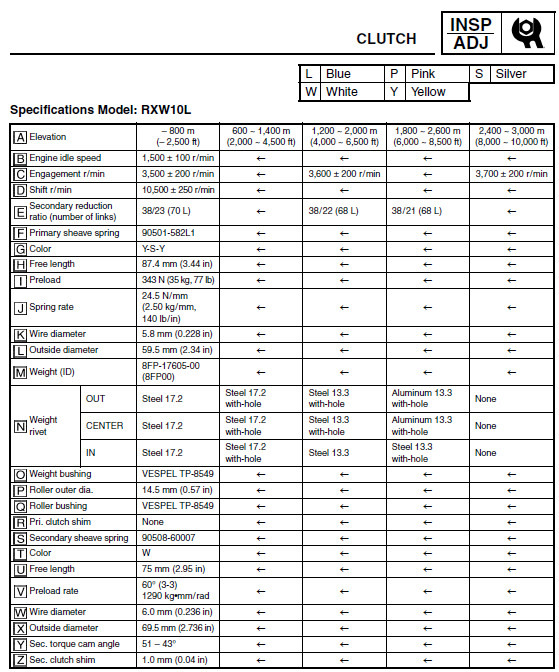

Based in part number on bag yes but how can I confirm the spring? Number of turns? Thickness of coils?
Lots of specs below the part number in the chart to verify the right spring.

Thanks! I didn't look closely at the whole chart on my phone, so didn't see the other values. I'm sure it's right, but expected it to be white! Even the chart says white.

Yep and if it was multi colored, you would have a line of that color to the left or right of the white line (eg. orange-pink-orange). Other than that one coil having the single dash or series of dashes is all there is.

Ha ha. I expected it all to be white. Easily missed that.

Yamaha secondary springs will be all black with the color of the spring as a single dot. Primary Yamaha springs will have 3 colored dots to represent which spring it is.
