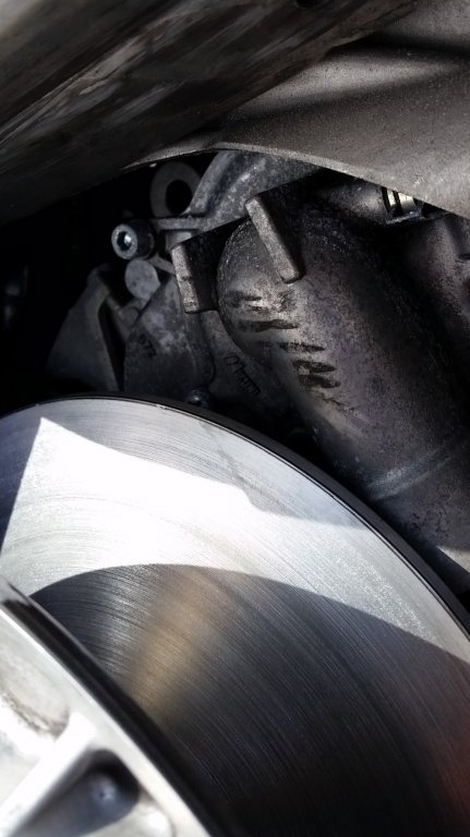

Yes, I am machined. Been machining Yamaha clutches for overdrive for years. If I would have known prior to my machining that the inner sheave diameter was smaller, I wouldn't have touched it.
Dan, this is mocked up at a standstill and I did the same mock-up thing. My belt was about .040" from being flush with the top of the primary when I had a brand new belt and after I did the machining. Never thought it would climb over either. But under load, you can see in my video of clutching how the belt doesn't come at the primary straight on from the secondary, but more at a curve.....especially if you hit the brakes, rev limiter or bump. I will be hooking up my camera more showing more videos.
This video was just be-bopping down the trail....max speed was 50-60 mph.
This video was a short burst down the trail where max speed was 85mph
When my belt climbed over the primary sheave at 130gps, it was cut clean like a knife or grinder cut it. Also, the marks on the engine tell the tale. The inner sheave on mine shows clean all the way to the top...so my thinking is that my primary (being machined) carried the belt to the top edge, the top edge of the belt went over twisting the belt leaving the black marks on the moveable sheave and top edge of the inner sheave. After that, the belt went over pinching it between the engine and inner sheave where the sheave cut it.

Terry,
First off excellent video. I think this type of video footage can tell us a TON about what is going on with our belts and belt life. I find the one where you are trail riding so interesting, and the lack of tension and slap the belt seems to go thru.
Is there any way you can attach the cam so it is straight on? So its directly looking at the belt from topside somehow, just to see how straight it all runs under load?
As for the belt coming over the top.....I 100% agree with you, that looks like what happened, However I feel that since the belt is a certain length, and in the mockup the belt is BOTTOMED OUT in secondary, so it cannot go any higher in primary, Therefor it could not climb over top AND remain in one piece. Only way that belt can come out and overtop would be to massively stretch, since the secondary is holding it there bottomed out.
So I believe when your belt came out, over top and did what it did....It MUST have let go enough or somehow stretched that much to allow it to climb out.
I would love to see more video like this, I think its a telltale sign of whats actually happening under there. I hate to say it as Ive always loved the torsional design. But it sure seems that the compression setup is a more consistent setup when tuning, I know on the 1200 4tec many of us went from torsional back to compression with great success. Its easy on the DOO as the OD of their springs are same. I believe that is nearly impossible with this Helix YAM has, as its such a short pocket, and there are no compression springs that are even close to this size and fitment.
Has anyone tried a diff secondary? It makes me wonder if this type of roller with torsional can keep up , after watching your video.
Dan
