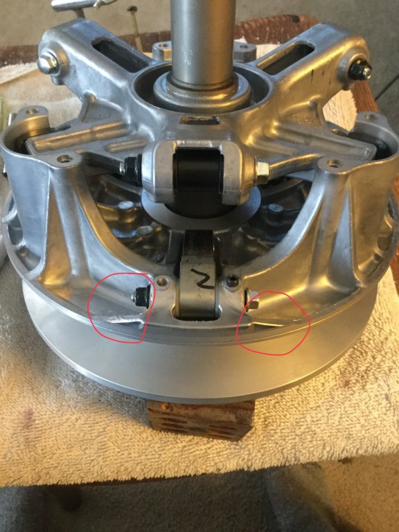

- 2017 side winder mtx 162
just the nut fell off i found the bolt and nut when i took off the panel roller rolled offNo its not stock. The weights have been changed.
Bolt fell out of the roller. Same issue some others have had. So either nuts falling off of bolt breaking, could be either one.

Had this happen Saturday AM. Yes, my bolts are installed per factory. After I get this fixed, they will be corrected. EVERYONE... needs to inspect their primary. 1500 miles. Rollers, pins and pin bolts need constant attention. Sliced up my secondary sheave too.

Guys, take your time when servicing these clutches. No excuses. Hand tighten these bolts, check everything twice. If you are not familiar with hand tightening, then use a torque wrench.

Warranty issue, no.
Safety issue, definitely YES!
I've said it many times...please let your dealer know this happened. Most likely they will not warranty this....but there have been a lot of bolts and nuts just coming apart, then losing rollers.
So on the pins and the weights nut and bolt is there a correct side the the nuts go on right or left as your facing the clutch on the sled

When the weight pocket and roller are at the top of the clutch (12 o'clock position), the bolt should go in the left side and the nut on the right side.
This keeps the bolt in the clutch during rotation.

Stock they come opposite, weird yam would not put them in oriented so they would help remain in place with nut off.When the weight pocket and roller are at the top of the clutch (12 o'clock position), the bolt should go in the left side and the nut on the right side.
Dan
Trust me, whoever assembled the clutches is not thinking too clearly.
Most of the ones we work on are that way.

Yeah I always thought it made no sense how mine were oriented from factory....Trust me, whoever assembled the clutches is not thinking too clearly.
I guess I change mine!
Thanks
Thanks
Dan
And loctite them

I had saved some of the original promo info that Yamaha released regarding the SideWinders back in 2017 and thought it was interesting to see in this diagram how they have the weight and roller bolts/nuts oriented:

Not saying that this clutch couldn't have been built stronger but I still have these thoughts... Now that I have a Sidewinder myself I have been on these forums, other forums and the FB threads. I swear 9 of every 10 Sidewinders out there has a flash. That being said if they are flashed the clutches have been apart at some point. So many of these clutch explosions seem to have a common trait, the roller pin fell out, the nut came off, etc. That seems to be the common situation I am seeing. Yes premature clutch wear is also an issue and that is going to happen when you add 50-80 HP to it, not to mention the engine harmonics.
So could this clutch be built better??..... darn right! Could the annoying rattle be remedied, yes. Not saying it is perfect by any means but just trying to be realistic.
