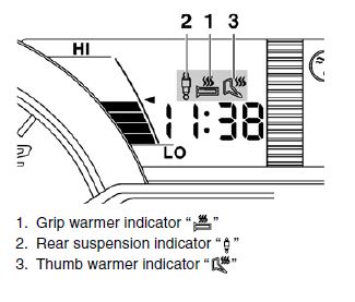

Considering your VIN came back as an RTX, it would appear someone added the GT seat and front Ohlins shock. If that is the case and your Apex is actually an RTX and not a GT, then I don't believe your Apex has the electronic Ohlins shock Kinger had mentioned. Considering the PO added the seat and front shocks, I suppose it's also possible he added the electronic shock but unless I am mistaken, he would have had to also swap out the ECU from a GT as well in order for the shock to be adjusted.What's the difference between the RTX and The GT? Because when I registered it the vin came back as an RTX
On the gauge pod, there is a Mode button that will toggle between the grip warmer indicator and the rear suspension compression damping indicator or shock indicator where either the grip icon or shock icon will appear on the dash. There is a rocker switch on the right side of the handlebars that is used to either adjust the grip warmer OR the rear suspension compression damping based off what the Mode button is set to. If Mode is set to grip warmer (ie. grip warmer indicator is displayed on the dash), cycling thru the rocker switch on the right side will cause the grip warmer indicator to display on the dash and will also display the bars used to indicate the heat setting the grip warmers are set at. If Mode is set to rear suspension compression damping (ie. shock indicator is displayed on the dash), cycling thru the rocker switch on the right side will cause the shock indicator to display on the dash and will also display the bars used to indicate the damping setting the rear shock is set at.

@Pabstkiller When you press the Mode button, do you see the dash toggle between the grip warmer indicator and the rear suspension compression damping indicator or shock indicator?
If not, then the solenoid in the rear Ohlins shock is bad or there is a short in the pigtail cable going from the shock solenoid to the connector in the wiring harness above chain case.

ill check it out and see if it pops up. if it doesn't do i have to replace the pigtail cable or is there a way to tell if the shack is set to the stiffest setting?( bigger guy lol)Thanks, @Stubbs as I did not realize all 06-10 Apex ECU had the ability to control the Ohlins EC rear shock.

If the shock indicator does not appear, then it could either be the pigtail OR the solenoid. My 08 Apex currently has over 18,0000 miles and I have never had an issue with the pigtail. Now, I have had to replace the shock solenoid and am on my 3rd one. I posted some tech exchange documents concerning the shock solenoid and cable routing of this pigtail in a different thread but here is a link to it. I've always followed the routing in the one Tech Exchange doc and never had an issue with cable breaking:
https://ty4stroke.com/threads/apex-ltx-rx-warrior-ecu-rear-shock.163814/
As for the compression damping setting the shock defaults to when the solenoid goes bad, unfortunately, it does not default to the stiffest setting but instead will remain at whatever setting it was previously set to before it went out. And, there is no way to determine what that setting is until either solenoid is replaced or the pigtail short is fixed/replaced and you can get the shock icon to appear on the dash.
