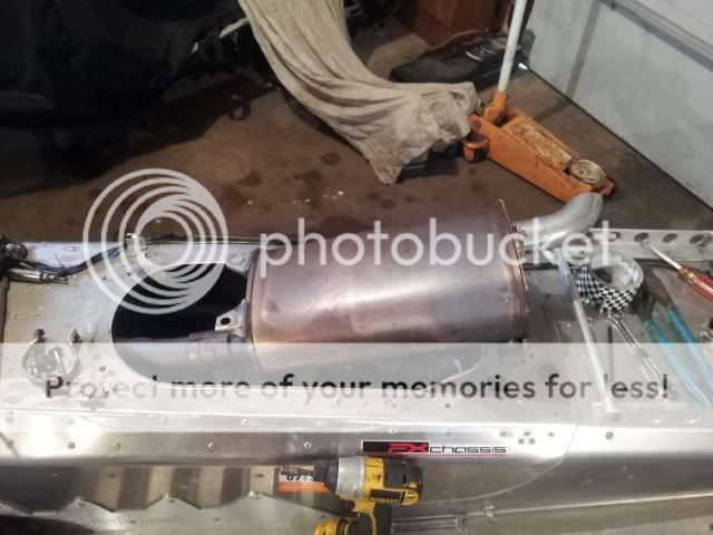

Wanted to get some sort of better sounding, better flowing, lighter exhaust on my nytro.
I had my stock exhaust laying around off of my 06 Suzuki LT-R 450 ATV. I think it is going to work great. It is a straight through muffler that is re-packable.
Take a look and let me know what you guys think.
Stock Exhaust
LT-R Exhaust all mounted up.
Its mounts up very easy I only had to cut the slip on pipe off the stock muffler and then cut the stock Suzuki exhaust and weld her up!
A view of the tip.
Stock Exhaust
A view of the tip.
justinkredible56
Looks real clean, kudos!
Mr.Johnson
Thanks man. I was very pleased on how it turned out for having absolutely no money into this.
