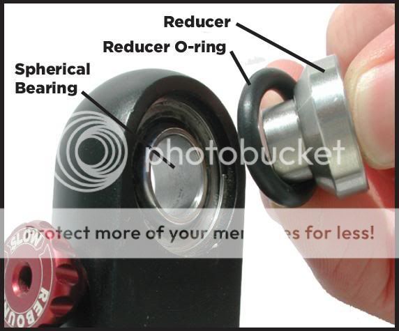

Whatever shock is used will have to have sperical bearings in the end eyelets of the shock similar to this:
There are coil over shocks that are like this, just a matter of finding the correct shock for the application. I believe they will be looking at this too.
My statement about not fitting the 08-09 OEM shocks was based on looking at a set from an 08 MTX and there did not appear to be a way to retrofit the fixed bushing on that shock with a spherical bearing.
Sit tight, there will be more information coming.
