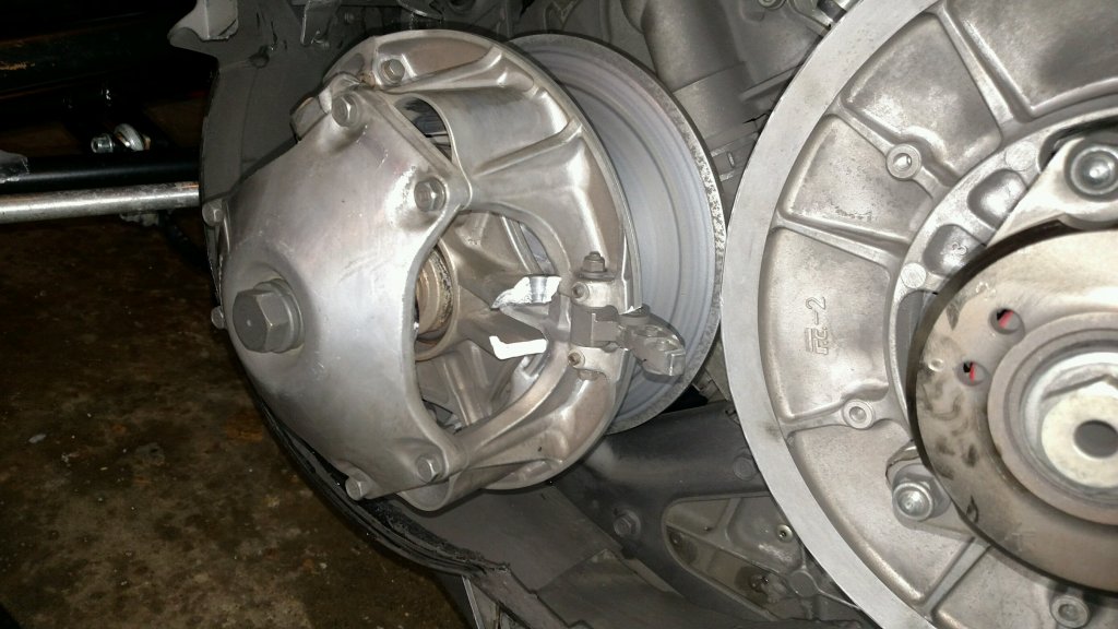

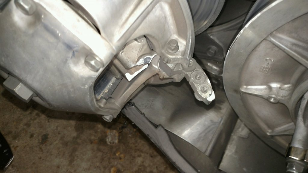

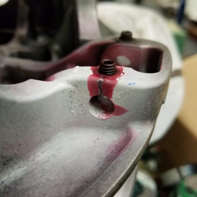

I would like to clear a couple things up here. 1st. HH or Heavy Hitter weights have never had a weight failure. It’s also been proven that the HH weight can’t go past the roller. That is directly from the owner/patent holder. 2nd. We know of over 60 blown sidewinder primary clutches so there is a problem which Yamaha is well aware of. Here are a couple that the clutch failed. The weight pocket cracks thru the pin and set screw and back of pocket breaks out. Also attached is a clutch that is cracked and caught before it blew. We found the cracks and then did die penetrant to confirm.

They crack no matter what weights are in them,stock,aftermarket. Just a matter of time before someone gets hurt of flying clutch pieces. I dont know what causing this,maybe the new design around the set screw ore more pulses from the engine to the clutch becouse of the new lighter stubshaft or the set screws are tighten to much?View attachment 141566 View attachment 141565 View attachment 141564

There is no radial bracing on the back of the pocket to support the forces that are being generated. Look at the previous Yamaha clutch and you’ll see the support webbing. Tarzan you are correct. We have seen completely stock machines break. Stock weights and tune.They crack no matter what weights are in them,stock,aftermarket. Just a matter of time before someone gets hurt of flying clutch pieces. I dont know what causing this,maybe the new design around the set screw ore more pulses from the engine to the clutch becouse of the new lighter stubshaft or the set screws are tighten to much?
