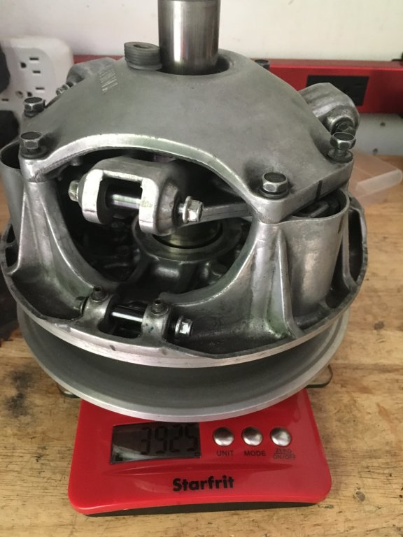

If we are just talking the Stubshaft and Primary clutch we know for sure the Stock Stubshaft in a Sidewinder has to be lighter than any before since the Relucter gear was removed. I know that doesnt seem like much but I am telling you guys even a 1/2 ounce in a assembly spinning 9000 rpm matters. That said has anyone ever weighed the old and new clutches?

The new clutch I would imagine weights more, I can weigh both at some point, but the castings and the spider are much thicker on the sidewinder clutches.

3925gr old and 4080gr SW
Awesome! Thanks for taking time to do that and share. Now we know wieght at least on clutch side of Stubshaft does not stop rattle.I was curious. Weighted pin and washer no weight no rooler

I’ve been running a viper primary since last December. It rattles just as bad as sidewinder clutch. Belt life is the same as a sidewinder clutch. But it doesn’t go boom. 1500 miles and no cracks. With our clutch weights I went 5 grams heavier with base weight and setup with same screws as sidewinder clutch.Awesome! Thanks for taking time to do that and share. Now we know wieght at least on clutch side of Stubshaft does not stop rattle.

Wow 5gr is a lot I never thought a result like that! It means that old c'utch work much more freely if I understand well? Now i wanna try it this winter.I’ve been running a viper primary since last December. It rattles just as bad as sidewinder clutch. Belt life is the same as a sidewinder clutch. But it doesn’t go boom. 1500 miles and no cracks. With our clutch weights I went 5 grams heavier with base weight and setup with same screws as sidewinder clutch.

The reason the Winder clutch takes less weight for same RPM, is the pivot point center being moved further out from the old Yamaha clutch. With the weights further out like that, they generate more shift force using less actual weight.
