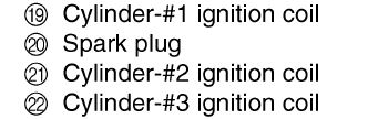

Just rebuilt a nytro motor and went to fire it up with no luck. Motor spits and sputters but no go. Just looking for ideas on what could be going on. I check fire and all plugs and coils are working. Now I'm thinking it's either fuel or timing.
1. Can I check the engine timing without removing the motor? I checked timming marks in mag cover and it seems correct with number 3 at tdc. Maybe I'm off 180 deg?
2. How do you remove the fuel line from fuel rail. I can't get it off and am wondering if that's my culprit. Possibly not on far enough and no fuel getting to rail (going out on a limb with that one). The connection seems different than the one at the tank.
Any ideas would be appreciated.

Well got the fuel line off. No issues there. Going to try one more time before pulling valve cover to check timming. My battery was a bit low as I cranked the motor over quite a few times to build some oil pressure before starting. Going to giv it a good charge before trying again.

She's running. Think it was a combination of old gas, low battery and wet plugs. Took awhile for it to clean itself out.
