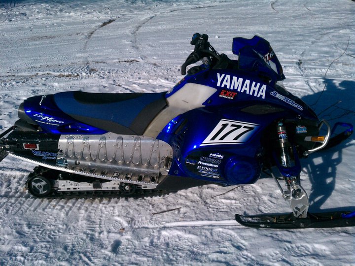

Look at the spind;les on my race sled pics you will see what I do to them...

I have never broken them down at the bushing I tend to bend them.

yam177 said:Look at the spind;les on my race sled pics you will see what I do to them...
What am I supposed to be looking at from this video? Can't tell as the spindles look stock? Can you provide a pic instead of the video clip?

http://www.ty4stroke.com/download.php?id=70207
Look close spindles are braced and so are the upper parts with longer bolts

yam177 said:http://www.ty4stroke.com/download.php?id=70207
Nicee! Good idea!
