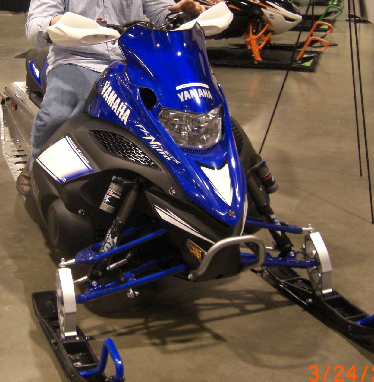

Okay so what is different on the 09 spindles?When we saw a SE at show my buddy said the spindles looked different but I couldnt see anything.
LJ 452

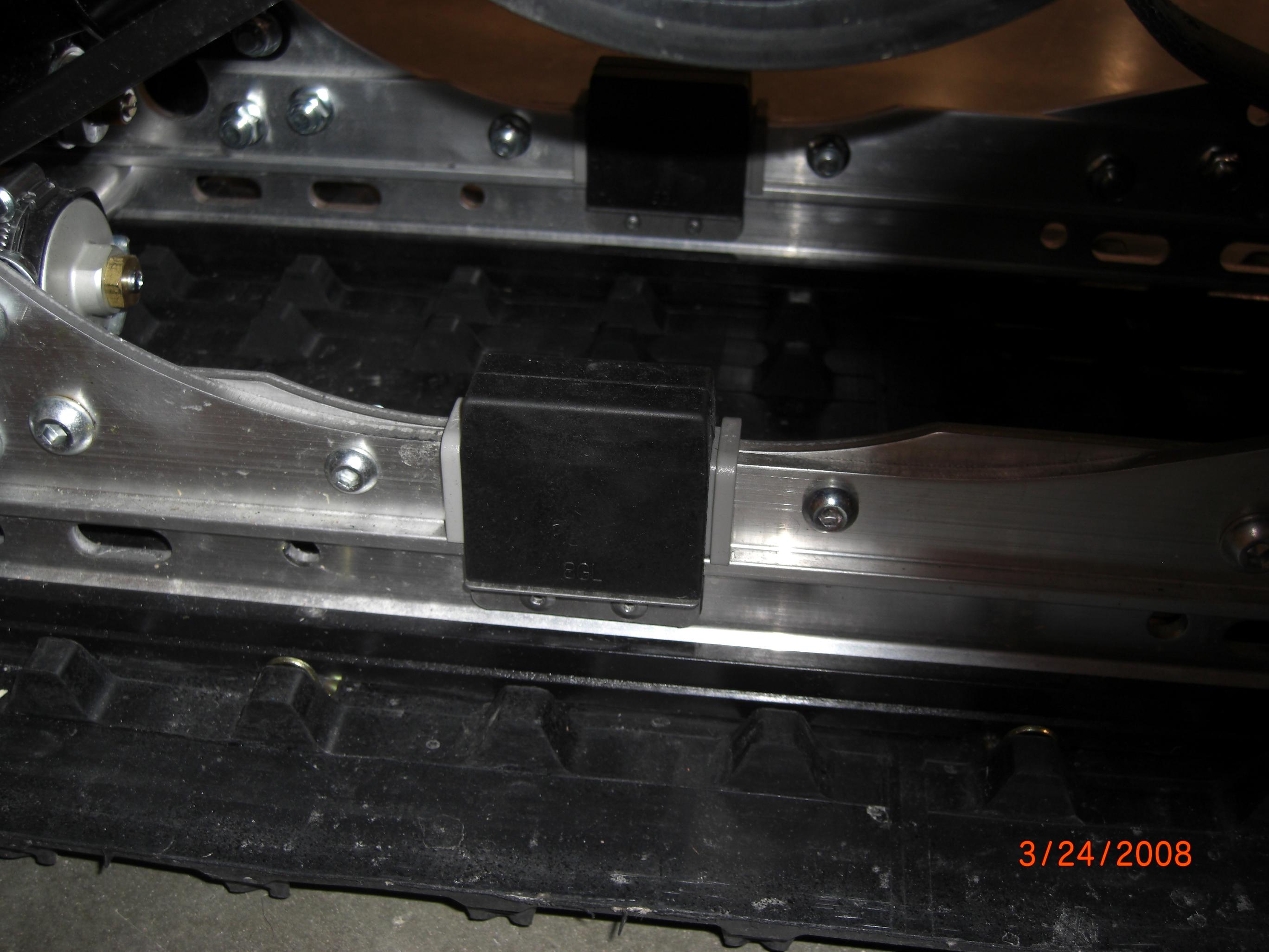

I got some pics of the front and rear susp. on the S.E.. Problem is they were taken on my buddies camera.
So I wont have them until Mon. Anyone else got any pics?
So I wont have them until Mon. Anyone else got any pics?GT03235

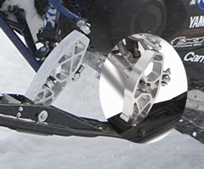

You guy's need some of these. My brother made these for ovel racing. The ones on the 07 phazer last year bent after the 2nd race on hard ice. He renforced the phazer's with a plate on the out side, but still bent. He had to weld a bar up the middle to keep it strate. So when he got the 08 Nytro, he made his own out of 7075 aluminum, and he shorten them up for ovel racing to get lower. I think he could shave a little more off to get them a little lighter, but they don't bend

PureBlue said:You guy's need some of these. My brother made these for ovel racing. The ones on the 07 phazer last year bent after the 2nd race on hard ice. He renforced the phazer's with a plate on the out side, but still bent. He had to weld a bar up the middle to keep it strate. So when he got the 08 Nytro, he made his own out of 7075 aluminum, and he shorten them up for ovel racing to get lower. I think he could shave a little more off to get them a little lighter, but they don't bend![]()
OK, I'll bite. What's ER? Are you volunteering your brother to start building these?

ER is for Eichenberg (Ikenberg) Racing. He shoud, but he doesn't have time or a CNC to make them. Belmont Engineering was going to make some for the Nytro, but they wanted $1000.00 to make them. Like they did with the RX-1 and Apex.Zoggan said:PureBlue said:You guy's need some of these. My brother made these for ovel racing. The ones on the 07 phazer last year bent after the 2nd race on hard ice. He renforced the phazer's with a plate on the out side, but still bent. He had to weld a bar up the middle to keep it strate. So when he got the 08 Nytro, he made his own out of 7075 aluminum, and he shorten them up for ovel racing to get lower. I think he could shave a little more off to get them a little lighter, but they don't bend![]()

Got Apex RTX? said:I got some pics of the front and rear susp. on the S.E.. Problem is they were taken on my buddies camera.So I wont have them until Mon. Anyone else got any pics?
I was wondering if you can post these pics that you have?
At our area sled show, they didn't have the SE out on the floor. It was in a trailer without the shocks.
Much appreciated.
LJ 452
Grimm said:Got Apex RTX? said:I got some pics of the front and rear susp. on the S.E.. Problem is they were taken on my buddies camera.So I wont have them until Mon. Anyone else got any pics?
Much appreciated.
Hopefully this works.
