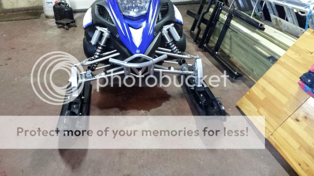

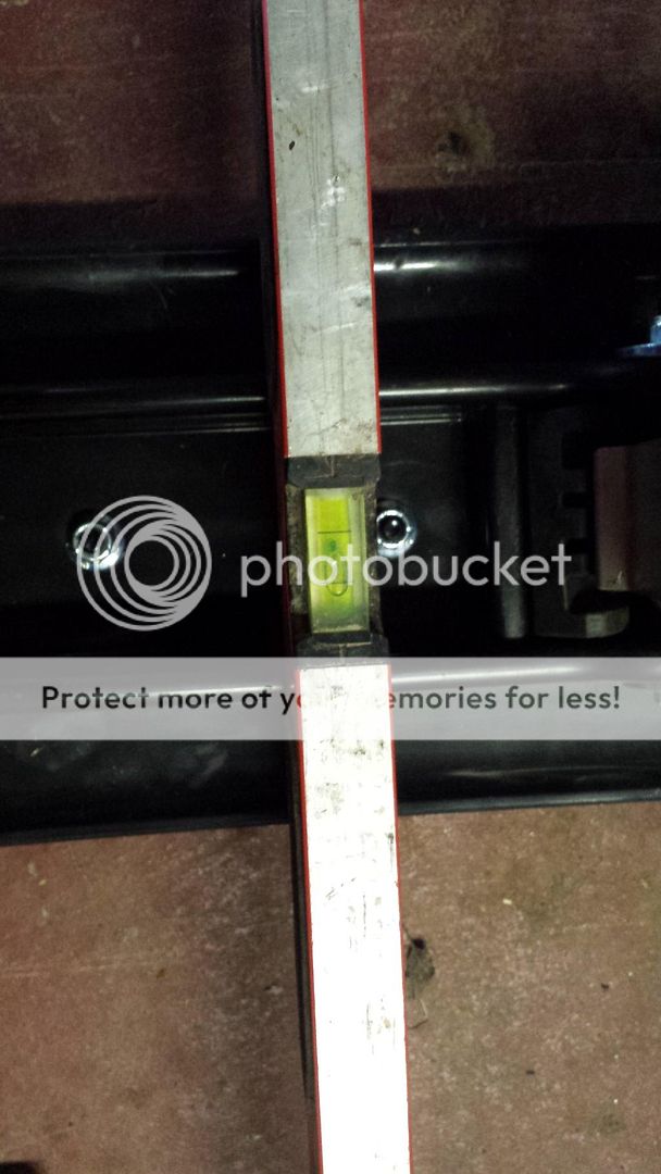

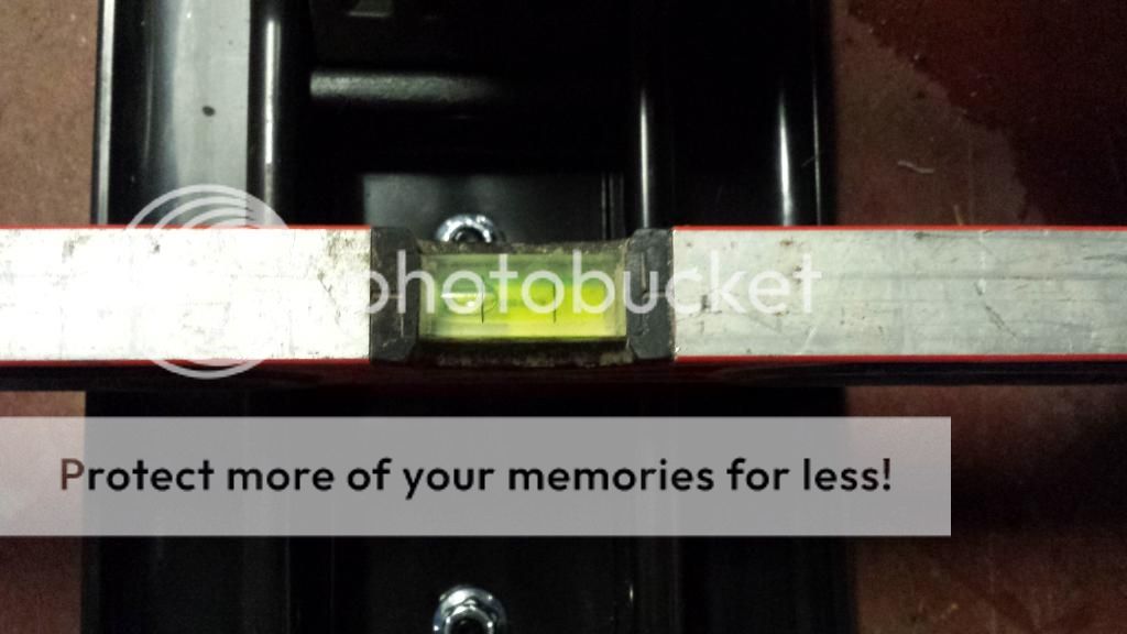

Hi all I just installed brand new C&A pro mtx skis on my nytro and after I noticed that the ski on the right hand side ( if you are sitting on it) leans more inside then the left ski I'll upload some pictures
This is the Right hand side ski
this is the left side
any one have an Idea were to start bent subframe ? or something fcked up with the spindles ?

Star at the top and work your way down.
- How is your subframe (lots of posts on how to check and repair)
- lift the front end and check the ball joints (excessive play)
- How were the ski spindles, do you have a lot of wiggle in there? Im putting in a new set from Upbushman this weekend.
Get your hands on everything in the frontend and wiggle shake and pry and for sure you will find the worn out part.
Mountaintech
Make sure the sled is sitting level as well, with both shocks equally adjusted. Unfortunately the stock suspension is totally non adjustable. One of the reasons the Mountaintech arms were developed was to be able to adjust both caster and camber independently. No other kit offers this.

Gotta be springs not adjusted the same or maybe even a shock out of whack .....
