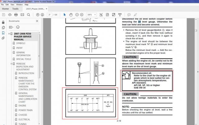

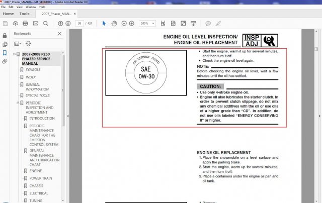

This subject has been beaten to death. Use what you want and put forward your opinion but please don't fear monger like Yamaha and their dealers. These engines are so reliable, they could probably run on bacon grease. Even Yamaha's repair manual doesn't say to use Yamalube. Attached are screenshots from their repair manual.
PS: Yeah, I use 0W40, which is not the recommended weight. I'm probably losing 0.5HP because of the oh-so-slightly thicker oil but I get better lubrication as a trade off.
That is utter BS! I've used Mobil 1 for the past 8 years and have +14k km on my MP. I take it regularly to 12k RPM and it hasn't blown up. In fact, I had it analyzed a couple of times and nothing out of the ordinary was found. Both of my sons with their Phazers also use it and they ABUSE their sleds. Lots of other people here have used it and are still ticking. Heck, in all the years I've been here, I haven't heard a single engine failure attributable to the oil.
As long as it doesn't say "Energy Conserving", it will be fine but one with a higher zinc content (or ZDDP) is better, like the European Formula, is better.
