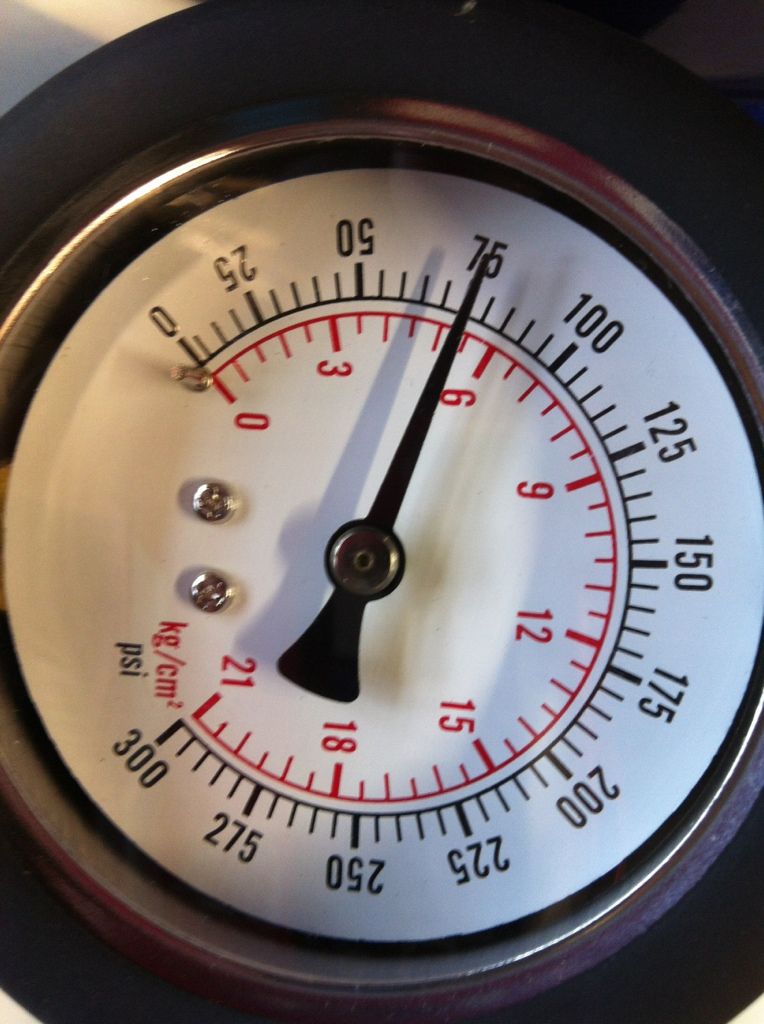

I performed a compression test on it today, which turned out good.
Just as the spec in the manual states. I also squirted a couple drops of oil in the cylinder and did another test, which turned out with the exact same result. If I got right that means that my rings are okay.
Could it be that the oil im using gets to thin for longer harder runs? Like the one i had this weekend?
I was running fully synthetic 10W40.
Either way I replaced the oil today with a mineral 15W40.
Whats your opinion?
