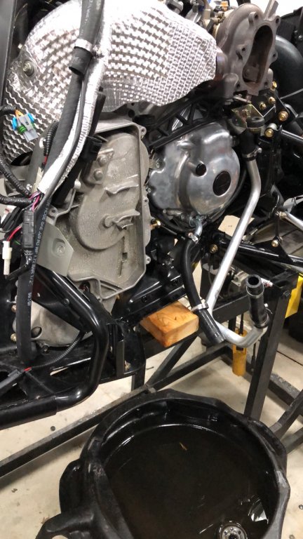

View attachment 137635 View attachment 137634
Just did mine yesterday there’s a groove Dan easy to do. One ride with only 550 km on the sled.roll over valve mod done at 39 km it was new old stock
And also I thank cannondale give me some info
Hammer,
Did you place the new seal without taking the chaincase cover off? and
Do you just lay a solid bead of sealant around the groove and screw the tank back on? Loctite on the bolts?
Thanks

Yes did it on sled put nice bead silicone 1/8” you will fill the grove,you will see what I mean. Clean all holes and bolts with brake clean , blow out with air. Apply blue loctite a good amount tighten down skip every other one x pattern let dry 24hrs and your good to go
I torqued to 96” lbs

Did you have to remove the lower side panel?Sevey
Hammer70
GRIPNRIP
- Sep 6, 2015
- 824
- 651
- 1,228
- Niagara, Ontario.
Y
Yes way to nice to work on and I replaced the 9rivets with rivet nut insertDid you have to remove the lower side panel?

On my 2014 Viper the oil tank dripped after one season. Took the oil tank apart when servicing chaincase and resealed using permatex ultra black, never leaked again .
I found very little sealer from factory.So far 2017 Sidewinder still dry. 5600 kms
I think/hope the issue is only on the 18’s. My 17 LTX is dry. The 18 RTX 50th has already been to the dealer at 600kms for a reseal and refill. Nothing since then....

If you have a leak check the 2 bolts/screws holding the connector elbow at the bottom of the tank. One of my bolts wasn’t tight and the elbow wasnt sitting flush. Not sure if this was where mine was leaking as I didn’t notice until after tank was removed but it’s worth checking I think.
