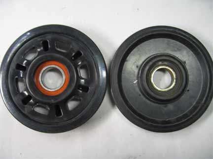

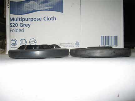

I have been reading much about the 6 idler wheels on my 2006 Vector GT. These are the 130mm wheels with 25 mm id bearing. Wheels are crap - dealer already replaced them under warrenty when the originals delaminated. Now I put about 3,000 miles on the replacements and several are "wobbly" -- bearings are shot (but the wheel has not destructed like before). Of course these wheels from Yamaha are not the ones you can change bearing on - they are molded in.
Checked with the dealer and the replacement wheels are $54 EACH. Then started researching the issue here on TY. After reading much a bunch I thought I would order the Yamaha "Accessory" wheels that list for $22 part # SMA-8FP38-01-BK as mentioned on numerous posts here on TY. But dealer said they didn't have any in stock and that Yamaha was back ordered and didn't know when they could even order them - said to check back in a week.
Went to HP Engineering Catalog - no listing for my Yamaha.
Went to Dennis Kirk catalog, but it was unclear. Went to Dennis Kirk internet and it was wrong - had 2 different descriptions for same part. I called Dennis Kirk tech department and they agreed with me that listings were in error, but then they called their vendor (Parts Unlimited) and got the scoop and then called me back within an hour.
I ordered the part they told me to and they came today. I installed them and they are correct! It is 130MM outside diameter, 25mm inside diameter with a 6005 replaceable bearing (which Dennis Kirt does not carry, but is a common bearing).
The Dennis Kirk part number is: 06-646 and they cost $23 each bearing includied. I have to say that I GOT GREAT SERVICE FROM DENNIS KIRK TODAY!! THANK YOU!

THe numbers for the polaris wheels depend on what color you want. Yes they have 205 bearings that are larger and replaceable. I have a polaris skid and checked them against the yammie skid. They stick down the same amount on both applications. You will need to machine the yammie mounts in 1.5mm or .060" to keep the wheels centered with the larger whelel bearings. I did it, works great!

I have now put 400 miles on the Parts Unlimited wheels (from Dennis Kirk) as discussed above in my previous post in this thread. They are a perfect replacement for the Yami wheel - and have a replaceable bearing - no need to use the POO wheel which you then have to machine the mount to get the wheel to line up correctly.

Thanks for the pics and info mtkaboater. I just replaced the inner ilder wheel on my 06 apex, they were shot at only 2k miles. I bought the factory wheels $72 a piece, yikes! How have the new wheels held up for you?
