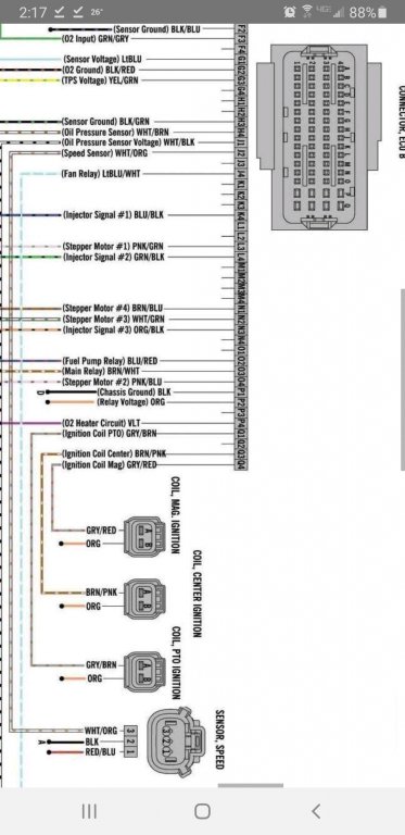

Wire diagrams. Check for broken wires to suspected cylinder coil.
https://ty4stroke.com/threads/anyone-have-a-legable-wire-schematic.141871/#post-1297360

Check for continuity between pin q1 at ecu connector and plug at coil.
Also check orange wire.

Make sure there is 12 volts at the orange wire. The orange wire should be 12 v constant and the ECU controls the ground( terminal A ) to fire the coil. If there is enough length on the leads, swap the PTO and center harness, plug the center connector into the PTO coil and vice versa, and let it idle, the code should STAY with the PTO side if it a wire problem because the ECU still thinks it is firing PTO coil
Like 1nc 2000 said, if there is resistance or an open on that wire or pin the ECU will trip a code.
I dont know there where any issues with the EVO flashes........maybe if you had another sled to try that ECU in it could tell you if the ECU is the problem.

When checking the wiring don’t just check with a meter. Load test them by applying voltage through the wire to power a load such as a test light. Meters can show good voltage or continuity but don’t tell if the wire can flow sufficient current.

unless you do a voltage drop test.....When checking the wiring don’t just check with a meter. Load test them by applying voltage through the wire to power a load such as a test light. Meters can show good voltage or continuity but don’t tell if the wire can flow sufficient current.
