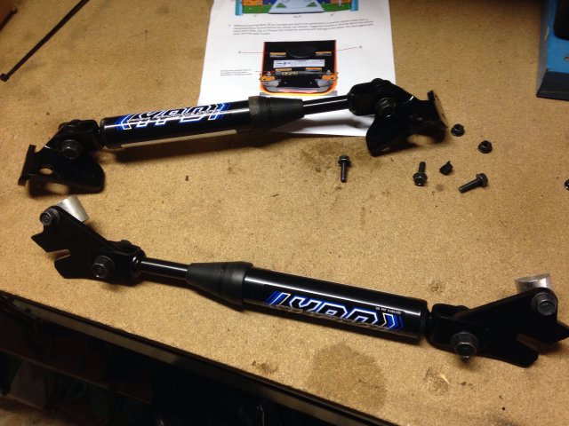

The rear is simple- drill out 2 rivits and drill 4 holes on the tunnel sides. The front you need to remove the hood and airbox and there is predrilled holes where the damper comes with brackets that bolt to the frame. I just installed these both yesterday. Not sure if the older models have the holes already drilled. Not sure if the dealer would have charged for the installation but its dissapointing that they dont come installed from the factory on these le models and i had to wait 6 weeks for them to be delivered to the dealer after i picked up the sled.

Pjw, How difficult is removing the air box? I have my dampers and I think for now I'm just going to install the front damper. I read your post, remove sides and hood, is there much attached to the air box? Did a search for how to didn't find anything.
Would be nice to have some pics for a airbox removal how too. If I remember right just air temp sensor is wired to it. Couple screws at front and you can just squeeze it out under radiator hose.
It isnt too hard- remove 3 hose clamps, a sensor connector and a few hoses. Then there is a bracket with 2 torx screws holding the airbox to the radiator and then 2 torx holding the front of the airbox to the frame and the airbox should come out. Follow the instructions on installing the brackets to the damper and make sure you have the shims in correctly to offset it so the damper doesnt hit the steering stem. The angles to tighten all of the damper fasteners are not very good and you'll have to use open end wrenchs to tighten most of the connections.From start to finish id say it will take 1 hr to 90 minutes
