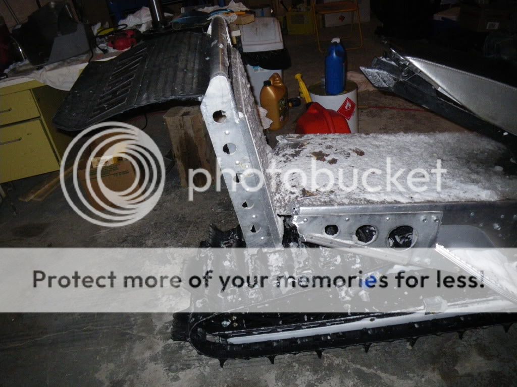

Little bit of an update here, I have the exhaust, tunnel and new boards finished up. Got my track trimmed the other weekend and got the track and skid installed tonight. I'm pretty pissed at timbersled because my skid has ~ 1000km on it and its pretty much shot. I grease it before and after every single ride and the shafts and bushings are pretty worn and every single shaft is bent. The upper rear arm and shaft are bent so badly that I couldn't remove the shaft. I figured I'll run it and hope it doesn't completely dissintegrate. I'm also unhappy with iceage because the adjustment is all the way off and the track is tighter than I want to run it. For 1000 bucks I really expected parts that won't require grinding. Oh well I guess I'll just have to break out the file #*$&@.

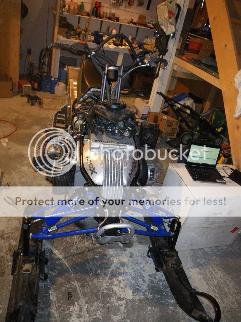

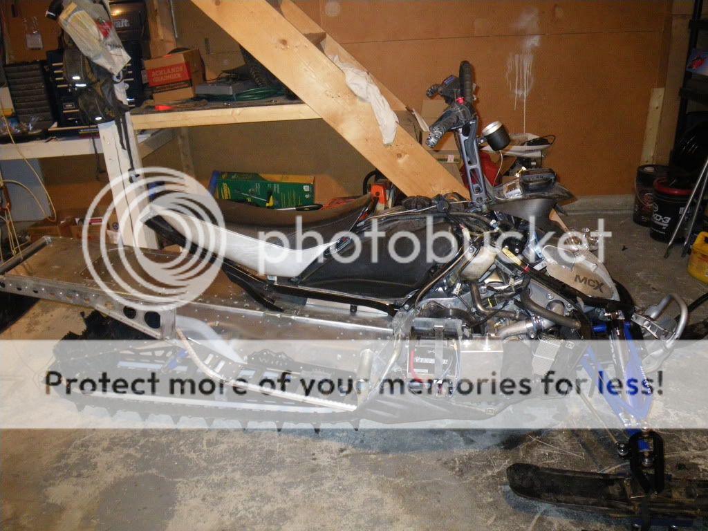

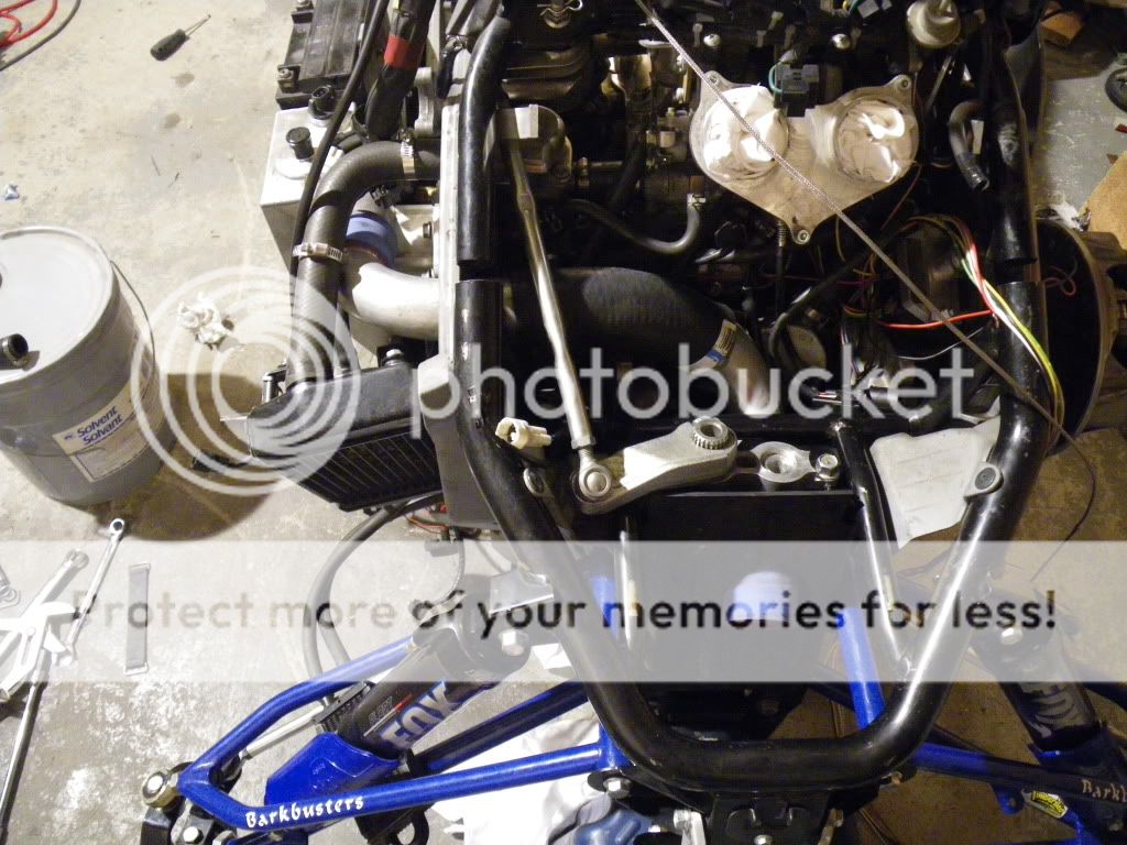

I finally got it running tonight, still have lots of little things to do like hook up the exhaust temp and install the tether/rov and get the intake outside the side panel but it runs and makes noise, a lot of noise. Right now one of my problems is trying to get the mcx box drivers to work on my windows 7 laptop so I can tune it. It needs lotsa fuel on the bottom end. I realy like how the charge tube plumbing worked out, cleaner than either kit originally was imo. I can't believe the intercooler that mpi included with the sc, the mcx one works awesome. Anyways, here's some pics!
yukonranger
Got the drivers working and added .5ms across the board and turned the c0 to 110. Started it up and it iddled low with afr 10.5 - 11.0 when i blipped the throttle it revved up and afr went ~17. when I let off the throttle it idled down a bit but stayed high with afr ~15-16. Wanna say thanks to UP bushman for his steering pivot kit. My lower steering is tighter than it's ever been
