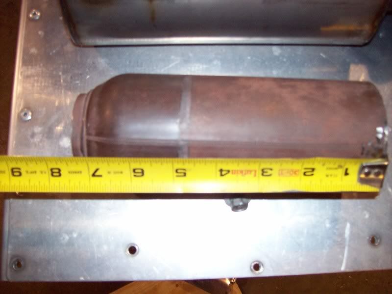

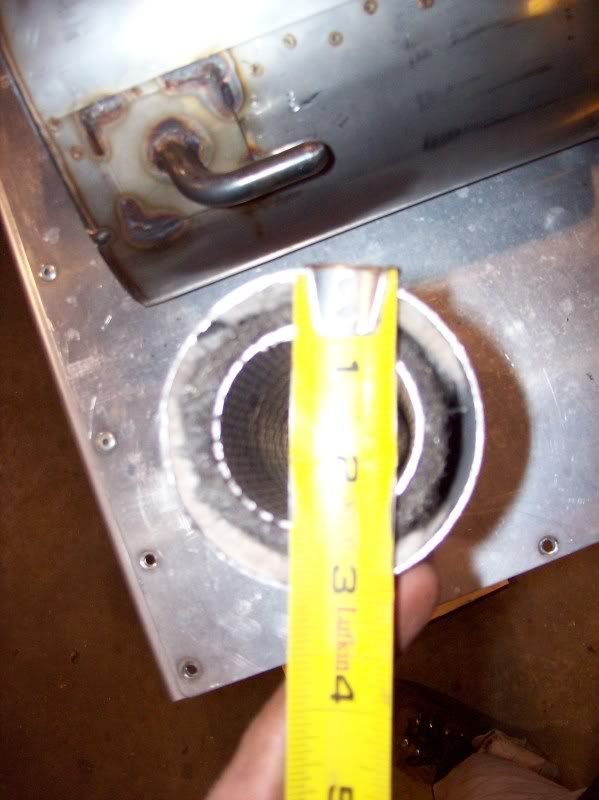

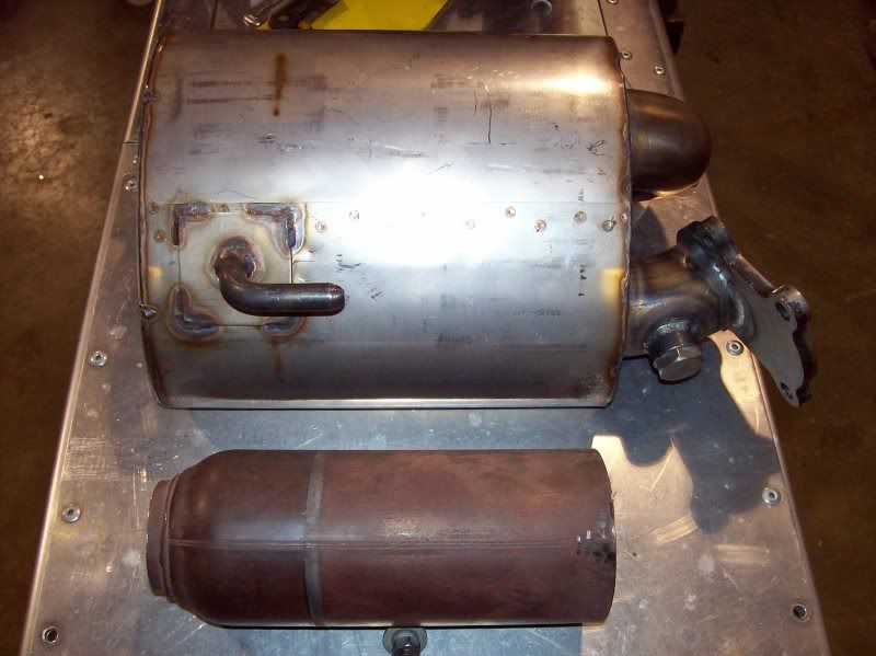

yukonranger said:Well, it's been a while since any updates on here so I will post some pics.
I decided to build a muffler using a small glasspack out of the butchered stock muffler.
Side by side comparison between the new muffler and the mcx muffler

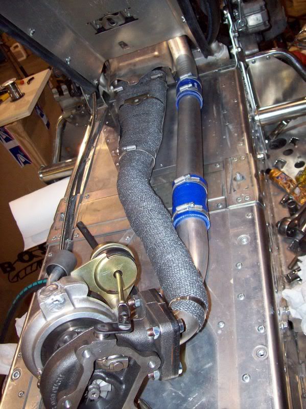

pipe wrapped and intake together

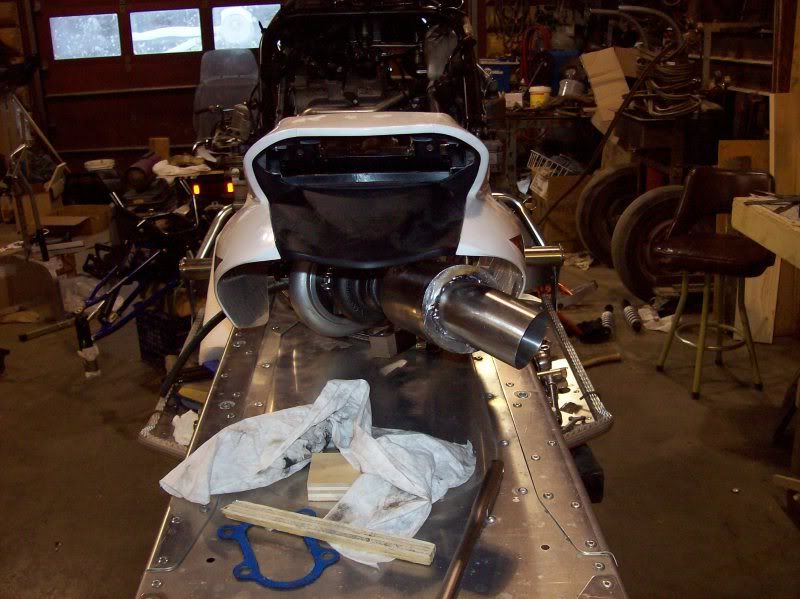

turbo and new muffler mounted
I also started into my wiring, only to find out that MCX has neglected to update the instructions as the kit changed. Although this was not in any way the fault of Prince George Yamaha, they have found the answers for me and are sending me some new wire harnesses and instruction. Don, Randy, and Harley sp? have been great and gotten this figured out very quickly.![]()

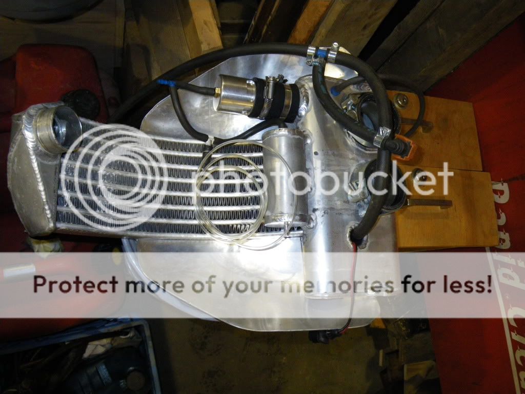

grimis99
I have to ask why did you weld that connection and move your BOV. Does this have something to do with space or is it because of the throttle body boots?
yukonranger
I didn't, this is a newer kit
grimis99
I didnt realize they changed that but i did buy a used kit so i probably have the first generation kit. Sure would be nicer to have the BOV on the intercooler like that.
yukonranger
Yah I think my kit is a gen 3.
