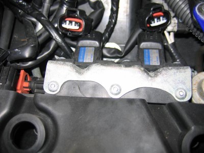

phazer wont start codes came up as intake pressure sensor hose problem hose is detached, loose ,plugged, ect,cyl #1 or cyl #2, where do i find these, thanks again

Here are the sensors.The hose is on the bottom of each of these.
