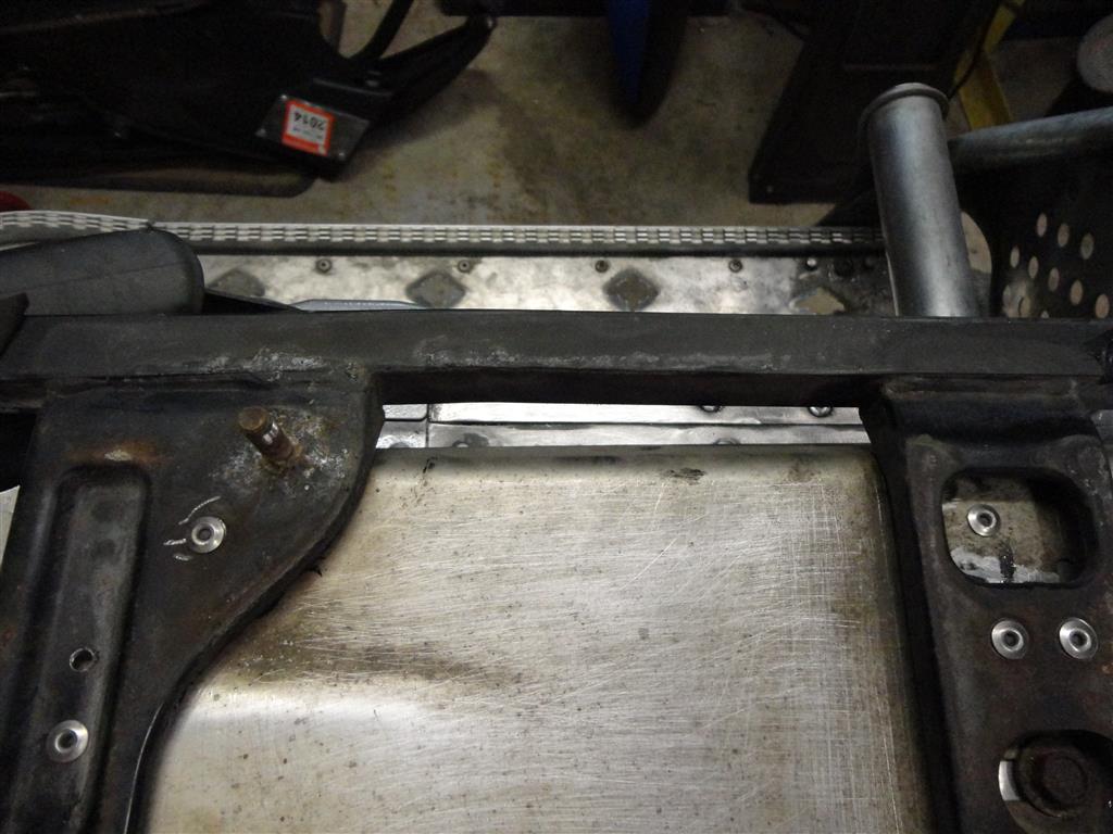

I put electrical tape on top of subframe where the steel heatshield rests way back in 07 that stuff is tough. Hasnt rubbed through at all. Scotch brand.

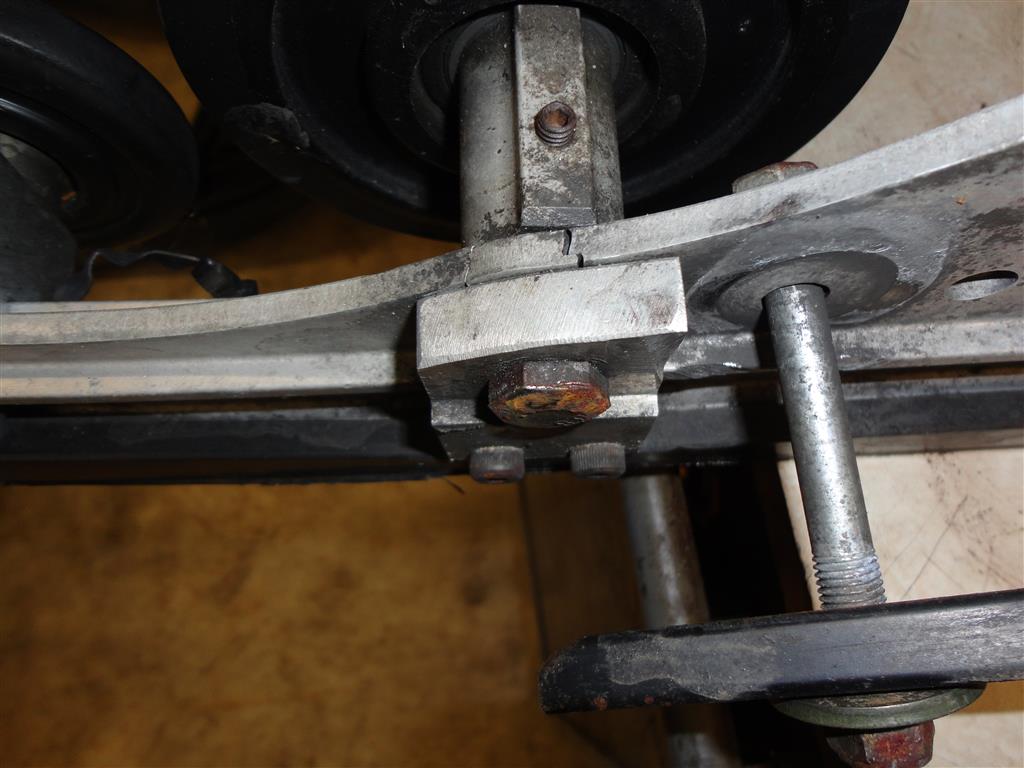

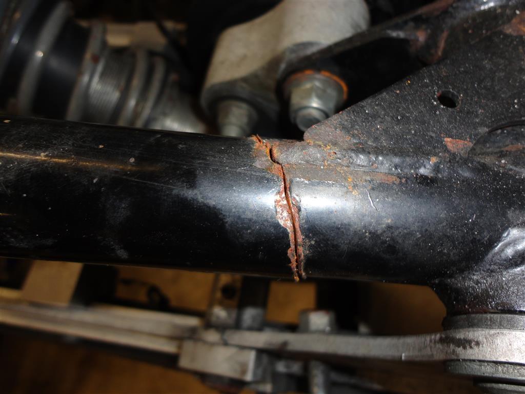

Got that done,seat and tank mounted. Moved on to dropping the rear suspension. Glad I did. I dont believe it has been dropped in 4 seasons.Oops! Both sides of front arm cracked. Right where weld ends. I wonder whether something can be done to prevent this? Must have happened on last ride since I would have seen it? Never noticed anything odd.

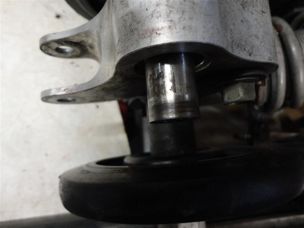

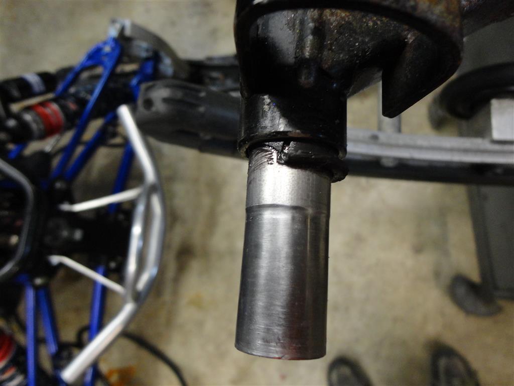

The shaft for the arm is also badly worn. Both ends. Plenty of grease just wore. May put a steel sleeve over it each end since shaft is Aluminum. Depends how much a new one would be.

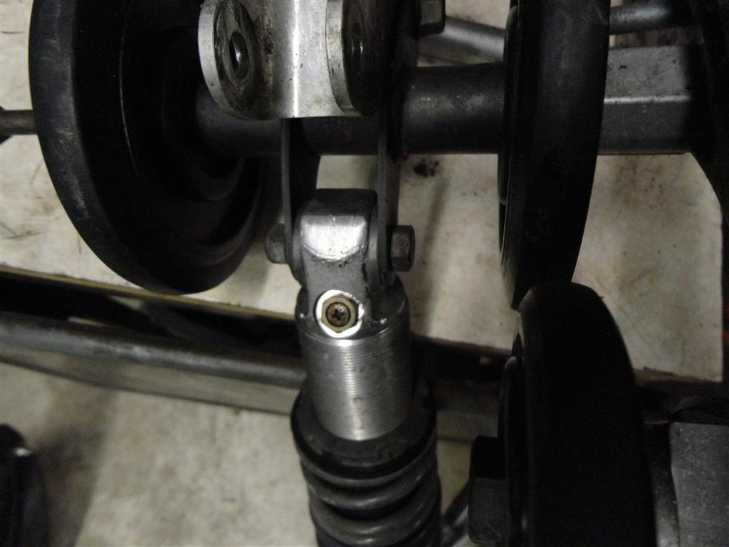

The Link and pivot along with the shaft they are on are doing fine. Clean and regrease is all. A little water must have got in as you can see some discoloration but nothing you can feel so will just polish the bushing.

Will have to get at drive bearings during the week. Ran out of time. She should be like new when done. Lot of work though and not looking forward to front arm and shaft cost but it earned it.

Are you going to just weld the front arm or replace it? You mentioned that the pivot shaft is aluminum. I just put mine back together and its steel. If the shoulder on the bushing breaks off the bushing can migrate towards the middle then cause the shaft to wear. Was your charge port on the front shock the right way?
The aluminum shafts are in the scissor and the upper front arm(where it bolts to tunnel). All the Pivot shafts are steel. I call the pivot the small shaft with two wheels that the link and lower center shock mount is on. And yes shock is mounted with fill down on mine. I will rotate it every few years to keep wear even on it. I will buy a new front arm and reinforce it. Bushings for front arm were in place. The wear is from the bushing.

PIvot arm goes for $158 and the shaft will run you $21. Price was from Partzilla.

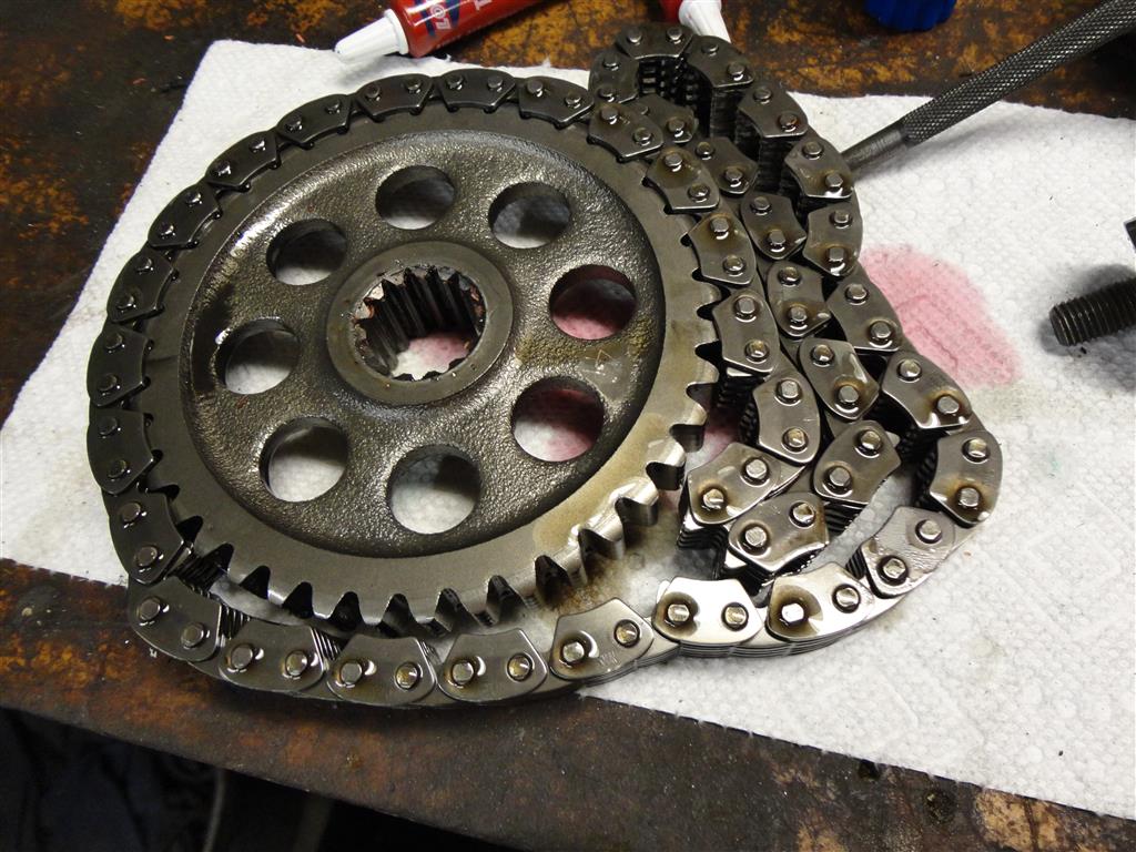

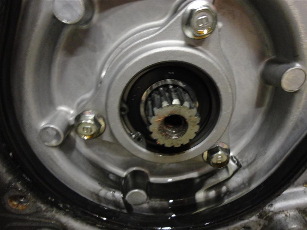

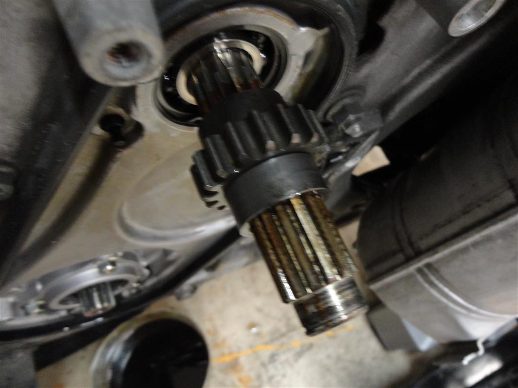

Ruggy that price isnt bad. I will for sure just buy new and compare/reinforce. You asked whether the lower chaincase bearing was put in stock with seal out. Yes it is. 3 seasons on it. Seems to be good as new. Everything in chaincase is perfect including chain and gears. No issues there.

Good to hear. Strange how yours is perfect and mine was completely shot after around 6,000 miles. I did install mine with the seal in so we'll see how ot does.
All it takes is for speedoside bearing to go from neglect and it can ruin everything. I take care of my bearings especially that one.
