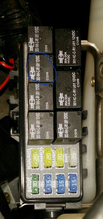

Looks to be the same as the one in lower right. Fan relay. Swapping them is also a option. What is the significance of the c1219 vs c1314 ?Pic of fusebox and relays. ISC relay (Idle Speed Control) blue. Maybe guys with poor idling will test and change the relay?

I wonder as well? Maybe Grizztracks know C1219 vs C1314?

According to the parts diagram all five of the 4 pin relays are the same so they all should be interchangeable. I don't see any reference to those extra numbers so I believe it's irrelevant.
Relay, 4-pin (20 amp)
Part# 8JP-H2189-00-00
The two shift relays are 5-pin (30 amp)
Part# 8JP-H2185-00-00
Get this. Here is mine. All the same number. Is that a Chinese Relay?

I guess it Chinese. I have been looking on Bosch relay but not found any replacement yet.

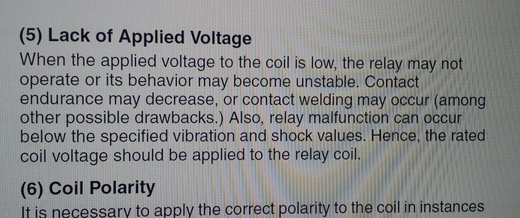

Found this when reading on Omron relays website.

Omron has put in one paragraph exactly what a low-voltage or under-voltage condition in a control circuit will do to the stability of an energized circuit. If a gasoline fired motor requires a fuel to be at a certain octane and the same motor is then used with a different type of fuel the results will be different than the design spec. The same would apply to electrical circuits, voltage representing the fuel and octane would be the 9.5, 11, 12-volts . Motor or circuit design, both depend on all of the components working together, but if the octane or the voltage is wrong....
It was just an analogy that came to mine while reading that paragraph.

Moisture and cold weather will eventually cause corrosion and freeze up of these relays like we see in all snowmobiles that run mechanical contact relays. I'm not sure of the quality of the relays being used but their specs are acceptable for most automotive applications. A pickup voltage of 7.2 volts should be sufficient however that spec is under ideal conditions, What happens when the temperature drops well below freezing and over time corrosion creates connection issues. The drop out voltage also could be much higher than the 1 volt so in reality it could be as high as the pickup voltage spec. The big problem I see here is that there are 3 relays that have to be powered for the engine to run so if any one of them fails it could leave you stranded. If the ECU is experiencing a low voltage situation then one way to correct the issue is to conserve power during the start cycle. Using solid state relays would be more reliable and also lower power consumption because they require very little voltage to activate them. I've also read that the O2 sensor is no longer needed with the new flash. If this is true was it removed to eliminate the O2 sensor's heater circuit load on the ECU?
