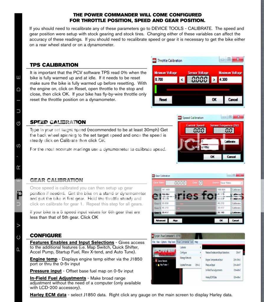

Did you adjust your TPS settings with the PCV software? You can download the users manual from Dynojet.

TPS calibrate
I did the software update and calibrated the throttle it still reads the same. I am getting a hold of Ulmer to see what he says. Anyone else have any other ideas?
