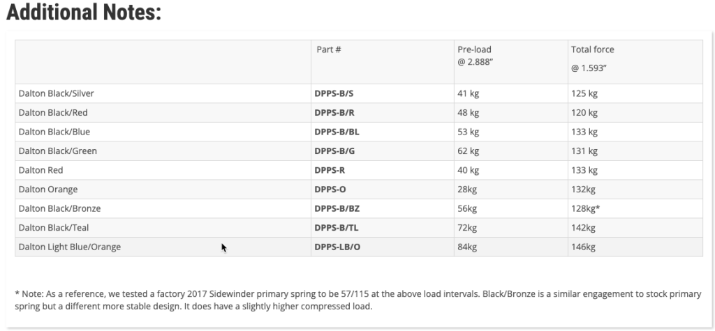

My primary is trying to tell me something. While I have no streaks of belt slippage, I am seeing the primary turn gray with belt dust and belt temps are manageable, but could always be cooler.
I'm assuming I need just a slight touch of additional pressure on belt, throughout the RPM.
The ultimax belt I have is showing approximately 1 mm of wear compared to new.
Max RPM is 8900 now. So I'm assuming more weight would help at the cost of dragging my RPM down further.
Was hoping a spring change might help, and I'll adjust accordingly.
Looking at this chart and would like some one to provide clarity as to what I'm looking at.

You're looking at a chart that applies to older Yamaha sleds.My primary is trying to tell me something. While I have no streaks of belt slippage, I am seeing the primary turn gray with belt dust and belt temps are manageable, but could always to cooler.
Looking at this chart and would like some one to provide clarity as to what I'm looking at. View attachment 177665
You need the long spring chart.
Colors are beside each other instead of on top of each other like above.

Sounds like you are close and have a belt temp gauge. Why not play with secondary and watch belt temps? Keep in mind any changes will change RPM. Weaker primary spring = lower rpm, but so does same primary spring and heavier weights. I'd increase and decrease the secondary by 10 degrees at a time and test. Lowest belt temps for the win.

Just be aware if you are running Dalton it will act differently then a Yamaha spring at the same rate. I run a Yamaha G-W-G in my Nytro(45/136). If i put a Dalton b/b spring in(53/133) i lose some op rpm. I was told that there is a 10+lbs finale rate difference between the 2.

Using Yamaha primary spring & Dalton secondary spring.Just be aware if you are running Dalton it will act differently then a Yamaha spring at the same rate. I run a Yamaha G-W-G in my Nytro(45/136). If i put a Dalton b/b spring in(53/133) i lose some op rpm. I was told that there is a 10+lbs finale rate difference between the 2.
I understand your assessment and that's why I want to take baby steps to correct this. It ain't that bad....lol.

lighter twist will lower rpm but also decrease side pressure. I doubt you are actually slipping the primary, but I'm not an expert. I'd go up and down 10 degrees on the secondary and see what belt temps tell you. As for Dalton.. They have a nice chart on their site that is helpful to compare rates.
