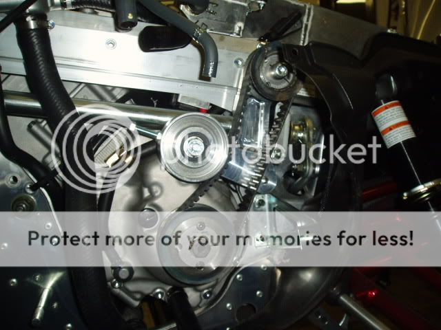

Today's progress was actually firing the motor and getting this bad boy running!
Supercharger Drive

Supercharger Drive
