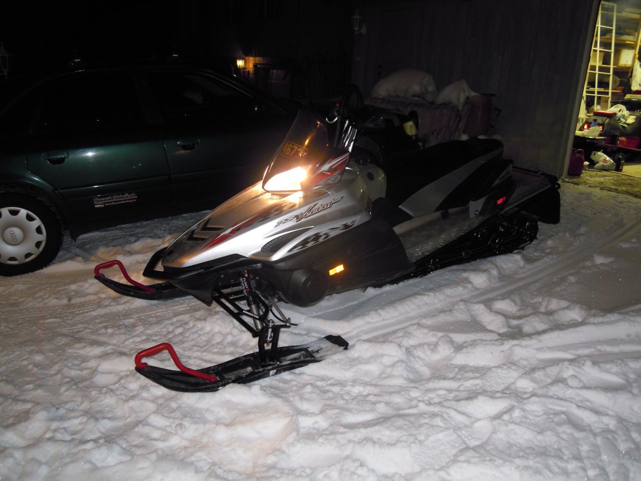

And finally, the sled is out of the garage and running
Will take some more pics the next days in daylight.

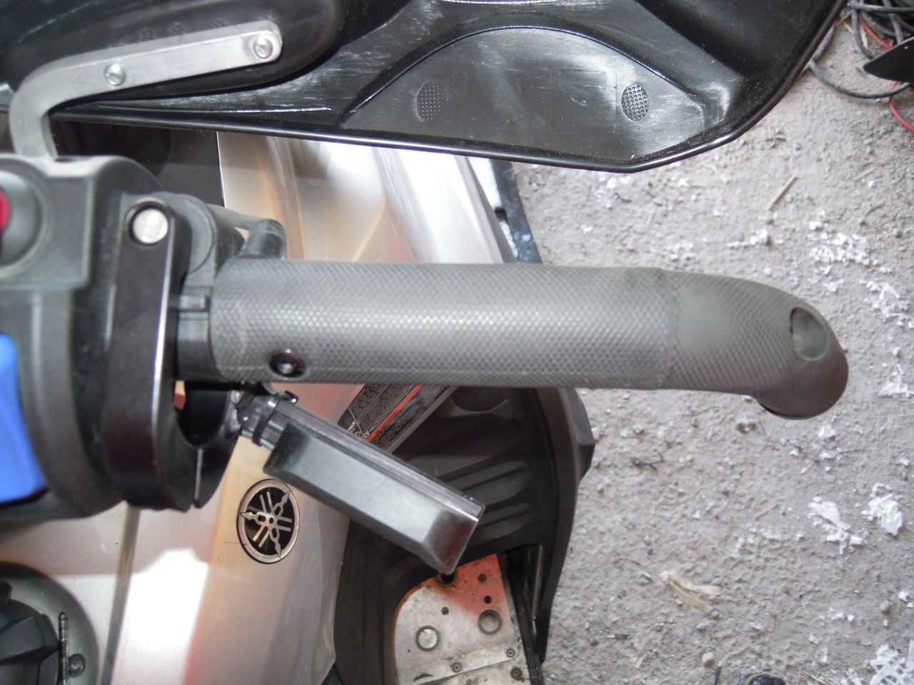

I almost forgot I had bought the NCI Thumb Drive, but got it mounted today
It's a real nice piece of engineering, and it fits perfectly! But, after driving approx 40 km / 30 miles today I'm not sure what to think about it. Might be a bit big for my hands or it might even be wrong adjustment, so the Thumb Drive is too far out. Will adjust it a bit in to check the difference

BUT, on my way back home today, while cruising along in in approx 30 mph the sled just DIED
She simply just died on me, some 15 miles from home...
Seems like there is no electricity to give spark to the engine. The starter works when turning the key and the engine spins around, so don't think it's the engine that's gone.
Well, anyway, need to take her to the dealer tomorrow to give her a check. Hope it's nothing major!!!
