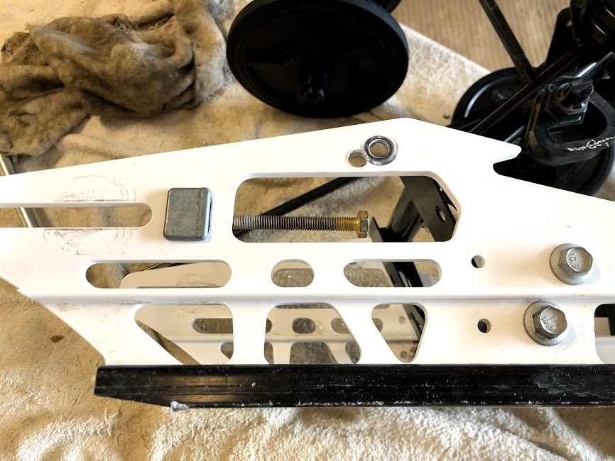

Yes. Thanks. I'll do this if I have issues with contacting the wheels with the blocks and rod removed. I realize now yours is a 129 so I'll double check the dimensions for my 137.129" for massive giggle factor, my fave sled to date and @270 I can play with nose using right thumb even at 60mph.
-Increase rebound setting on rear shock(make faster)
-Lengthen straps to longest holes, and oval out the holes some.
-Move transfer rod 7mm(pics)
This does not seem to do same on the 137, but may need to experiment if YAM never gives me a 129 again.

The 129 transfers better than the 137. We have one of each, no studs, identical suspensions settings. Mine will lift the skis at will, the 137 just spins.
The 137 handles better though. My Dad's is stuck to the trails like a magnet to a piece of steel.
OK, this has me intrigued. I'm dreading the move to 137, which I will have to do eventually. So when you say it's stuck. Like no inside ski lift? Or very little of it? I just can't get my winder to handle like the old 1100's did.

I might do that for mine...just the opposite way. I'd like to throttle it a bit more in the corners. Just lose too much ski pressure right now. My limiter strap is fully sucked in and my front shock has zero preload or the least amount possible.
0 inside ski lift. My Dad's 137 handles like a slot car. My 129 isn't as flat

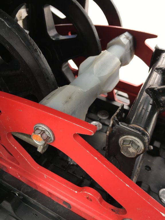

I have over 26 oookm whit this block, great fast tuning component. I modified it a little, position #6 is cut almost to the shaft, so no position #5 anymore.... I rarely use position #6 for fast trail riding.
I have also drill a hole through the block, up to the middle of the shaft to facilitate installation! The "spring ball" was always moving on the slot before bolt were tight enough. We need to put quality grease between the shaft and block to operate properly in extreme cold weather.
f

Hey I just lay on sled so scissors press against it and tighten up. My wife walked in the garage one day while I was laying on the sled reaching around to tighten the bolts and was very confused.I have over 26 oookm whit this block, great fast tuning component. I modified it a little, position #6 is cut almost to the shaft, so no position #5 anymore.... I rarely use position #6 for fast trail riding.View attachment 148099
fView attachment 148098

Loool. I know what you are talking about! When i tighten the bolts the shaft was spinning inside a little and the springball was of the slot inside the assembly . That's why i am holding the shaft whit a little pin or drillbit. Otherwise it was a pain in the #*$&@ to instal correctly...Hey I just lay on sled so scissors press against it and tighten up. My wife walked in the garage one day while I was laying on the sled reaching around to tighten the bolts and was very confused.
