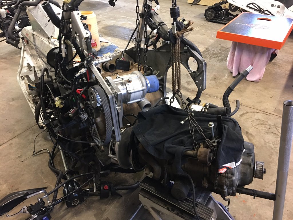

Even with a new radiator I'd be a little concerned with the radiator having pressure in it after it cools. If the coolant is low when the engine cools it normal creates a vacuum and pulls coolant from the overflow bottle. You still might have a head gasket issue. I've done several head gaskets on these engines and it's always a problem with combustion gas pressurizing the cooling system. I've never seen one have an external leak or burn coolant.
Just finished another head gasket job
Resurfaced head
This the worst plug radiator I've seen out of a Nytro.
Resurfaced head
