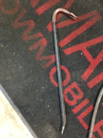

Just the rear is all thats needed to be dropped. Here is my little Knuckle Saver! Remember flat end of bar on inner race. Like Stain said get a spare wheel just in case. You will use it someday anyway.
Thanks for the picture! Are the upper idler wheels the same as the lower? If so, I did buy a couple spare ones this year as I lost the wheel last year on one of my lower. Figured having a couple might come in handy again.
No. Uppers are different size.
