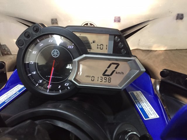

i would like to relocate my Oem dash gauge closer to the handlebars. I saw a post of using a ram mount to secure the gauge. How much extra wiring is available for this? I want to put my GPS where my dash gauge is. Thanks. Al

I want my gauge closer to the handlebar.

I relocated mine to the handlebars using the PHAZER bracket. I had to splice the wires and lengthen them an extra foot to make it work though.

I bought the Mountaintech gauge relocate and added a bout a foot. My plan some day is to make my own relocate a little longer as my handlebar bag makes it hard to see. A Vector gauge would be sweet if I run into a high mile cheap one.
mcamzr
X2Do it on the other way; keep your gauge in the oem place and install your GPS on the handlebar with ram mount...
I use ram mount for my vector gauge; no problem so far
