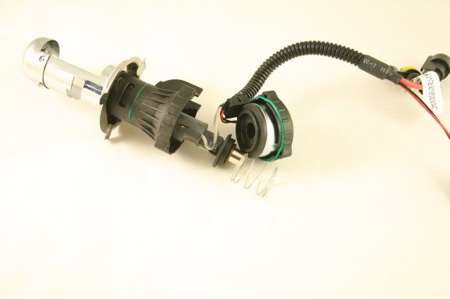

Not sure what to say on the price, but they are great lights. I just talked to Rock and confirmed that he is doing the double oring mod on the hi-lo to restrict travel. If you look back at my earlier posts you'll see where I posted pics and some measurements. It seems that someone originated the H4 hi-lo travel specs and everybody just copied it so they all have excessive travel. He is also adding a dab of silicone at the knuckle joint of the mechanism to dampen movement from vibration.
Any better pictures or description on how to add these O-rings to Rocz previous kits. Maybe the extra orings and labor account for the $ increase. Hunting for your previous posts now. Thanks.
The image attached shows just one oring. They are #011 orings that we just happen to stock. One was not enough and 2 seems to be perfect.
No intention of completely derailing yamadoos post, you mean the small black o-ring on the silver thing, next to the spring ? Double them up ? Any idea on the O-ring O.D. I also enjoy the good natured generosity of the T.Y. code supporting vendors, THANK YOU !
